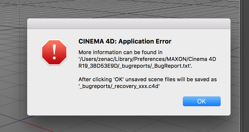

After I successfully install the octane standalone and octane for c4d. Every time I click the button of octane in c4d, C4d will crash.
My CUDA driver, C4D and octane are all the latest version.
I keep receiving a C4D Application Error:
More information can be found in
'/Users/zenac/Library/Preferences/MAXON/Cinema 4D R19_3BD53E9D/_bugreports/_BugReport.txt'.
After clicking 'OK' unsaved scene files will be saved as '_bugreports/_recovery_xxx.c4d'
How could I solve this problem?

Same problem here. macOS 10.13.6, latest Nvidia Driver and CUDA drivers installed. Standalone version 3.08 works fine and eGPU detected. Followed the C4d plugin installing guide. But still showing up the Application Error every time I opened C4d.
wuyue1990
Posts: 4
Joined: Wed Jan 03, 2018 2:23 am
SOLVED. Just don't forget to install the CUDA toolkit (latest version).
