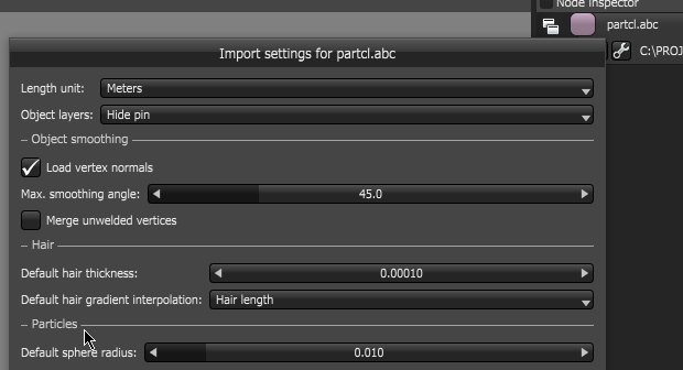

In Standalone or in an ORBX proxy node, you can change the spheres primitive radius in the import alembic settings, this doesn't update immediately you may have to save the scene and reload to see the change.

you can have different setting for different alembic node,
don't change the particle default sphere radius in preferences but in the setting of each alembic node :
