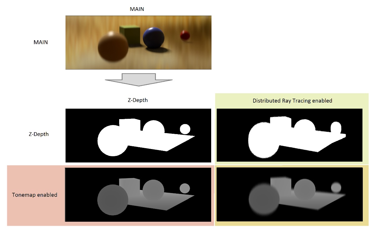

I want to control the Z-depth in post but Octane doesn't render out a perfect aliased z-depth pass. I get blurred edges. The anti-aliasing becomes depth etc.

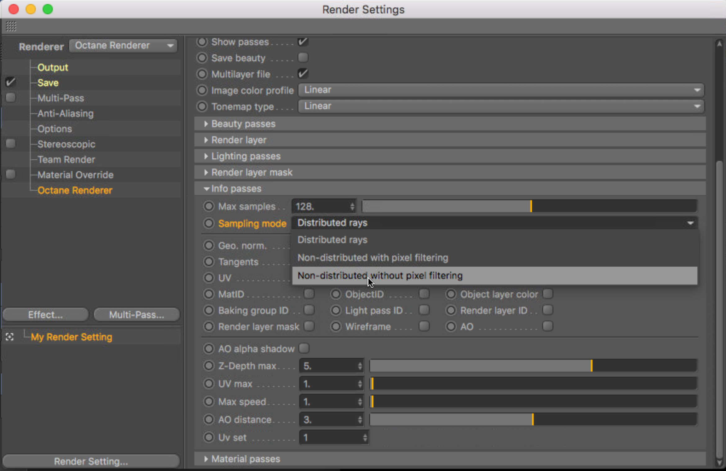

Can you tell me or maybe point me to a guide how to render an aliased z-depth pass? Is it even possible?
Posts: 10578
Hi.
You need to change the Sampling mode value in the Info Channell Pass Render Settings:
ciao Beppe
