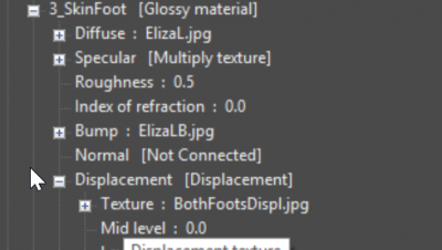

Is there a displacement node active in material for the feet? Check in the plugin material.
YES! :O :
Core I7-8700K, 32RAM, GTX1080Ti, win10
gsfcreator
Posts: 129
Joined: Sat Mar 31, 2018 9:45 pm
wimvdb wrote:The legs render normally for me with Eliza morphs applied.
It does not look like a mesh break either. It almost looks as if there is negative displacement active. But the supplied skin textures of Eliza do not have displacement maps.
you are a mere genius. I disconnected the displacement and the issue solved!

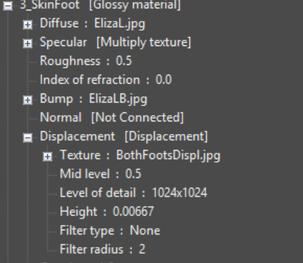

Ok, look at the displacement map and see if it is a black or gray zero level map. If you see actual black in the displacement map, it is most likely a black zero level map.
Set the mid level to 0. This will fix it.

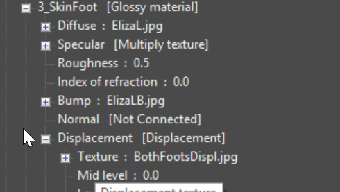

I had a displacement, as wimVdb mentioned, that wasn't came originally with the figure. when I disconnected it, the render worked properly, but I lost the displacement's purpose (in this case = realistic wrinkles on her soles).
played around. kept the discplacement and changed displacement --> texture --> mid level from 0.5 to 0. problem solved! :)
