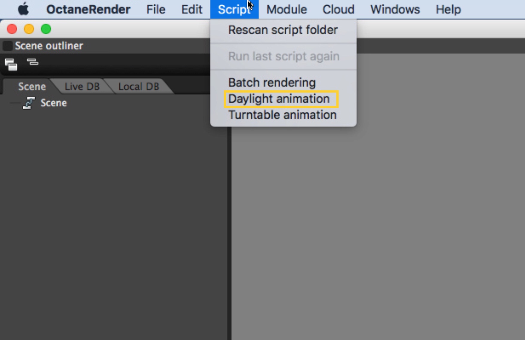

the Daylight animation should be already listed in the Script menu, alonge with Batch rendering and Turntable:
Just select the desired Render Target node with Daylight Environment node, go to the Script menu and choose the Daylight script:

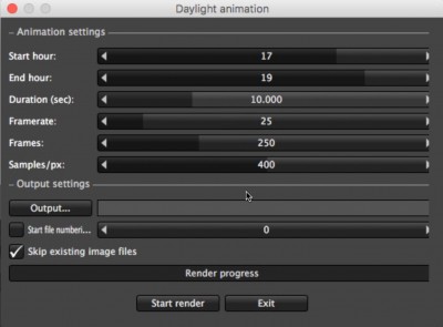

Set the Start time, End time, duration, saving path, and render.
