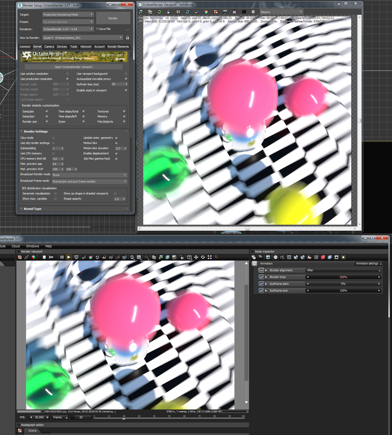

Hi Paulforgy,
Octane for 3dsMax 3.07 - 4.44 seems to work well exporting to .orbx.
As you can see in my screenshots, MB matches and Gamma too.
I do not know your settings, you could take a look at mine; could they help you?
Regards
Paride

Motion blur doesn't work. Try turning it off in kernel settings and see if that looks correct in standalone.

No. Try exporting from Max with motion blur set to off. Import that into standalone, and it will still be on.paride4331 wrote:Is it correct?paulforgy wrote:Gamma was an issue on my end.paride4331 wrote:Hi Paulforgy,

That's the bug.

Hi paulforgy,
ok I see what you said, MB issue seems to be turning off it. I reported that to developers.
Work around > export to SA > turn off MB > export to ORC
Regards
Paride
