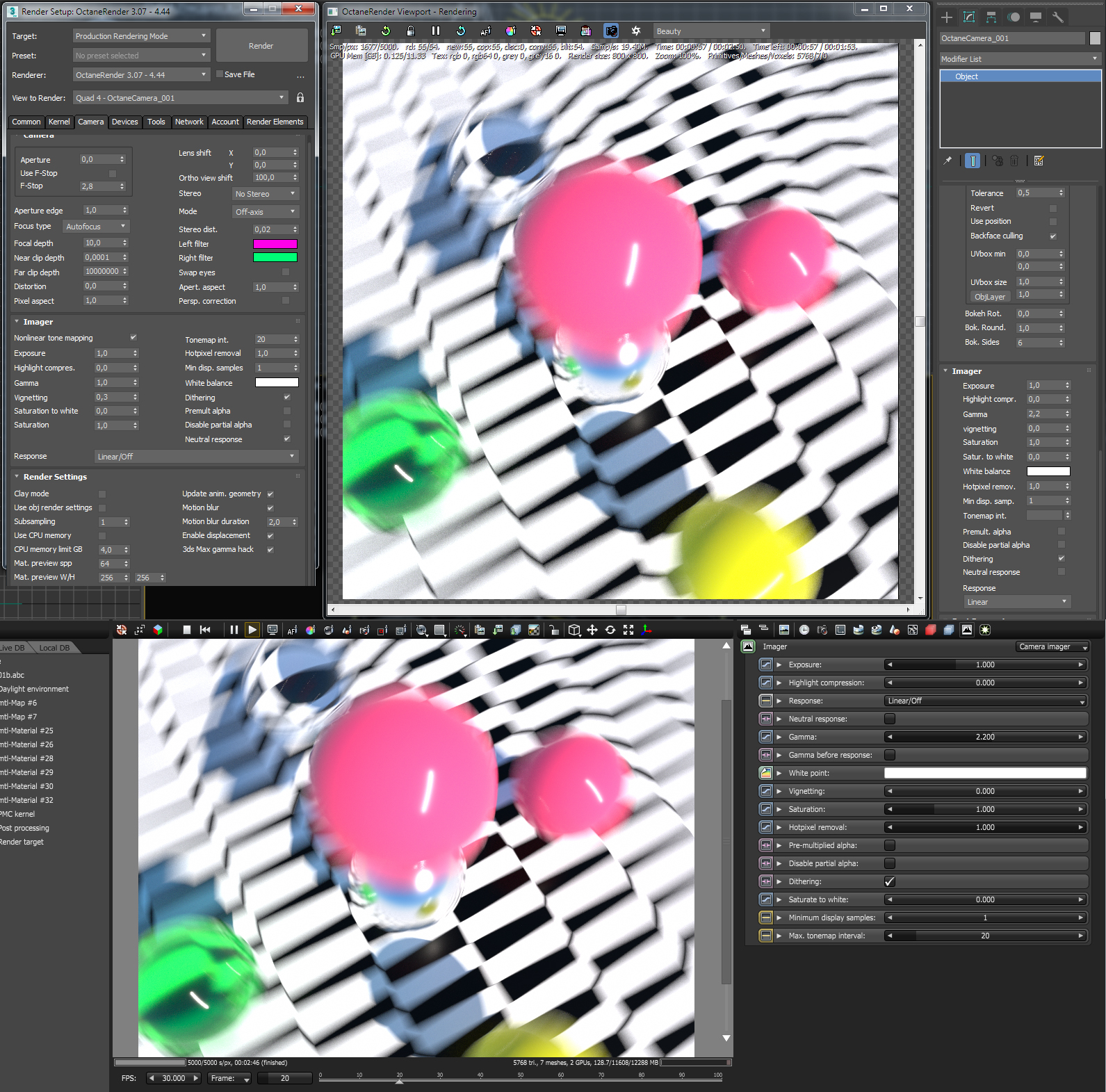

paride4331
Posts: 4002
Hi Paulforgy,
Octane for 3dsMax 3.07 - 4.44 seems to work well exporting to .orbx.
As you can see in my screenshots, MB matches and Gamma too.
I do not know your settings, you could take a look at mine; could they help you?
Regards
Paride

paride4331
Posts: 4002
paulforgy wrote:
paride4331 wrote:Hi Paulforgy,
Regards
Paride
Gamma was an issue on my end.
Motion blur doesn't work. Try turning it off in kernel settings and see if that looks correct in standalone.
Is it correct?
Regards
Paride

paride4331
Posts: 4002
Hi paulforgy,
ok I see what you said, MB issue seems to be turning off it. I reported that to developers.
Work around > export to SA > turn off MB > export to ORC
Regards
Paride
