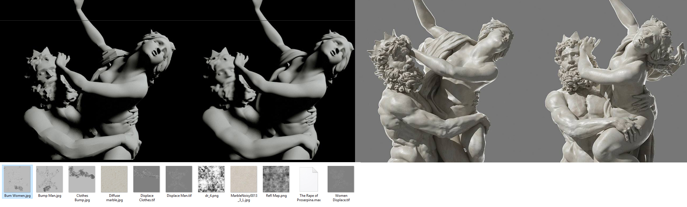

Not necessarily an Octane question directly but just got this model from Turbosquid and wanted to play with it in the renderer. The obj comes in jagged like the left image. When i add a subdivision surface it becomes too smooth and neither look like the original model over grey. Any suggestions on what i could adjust in the import settings or afterwards?
The model came with the maps pictured but i've tried all the different mapping techniques and they all come in in a funky way still.

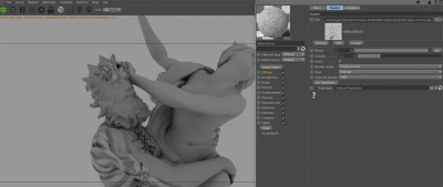

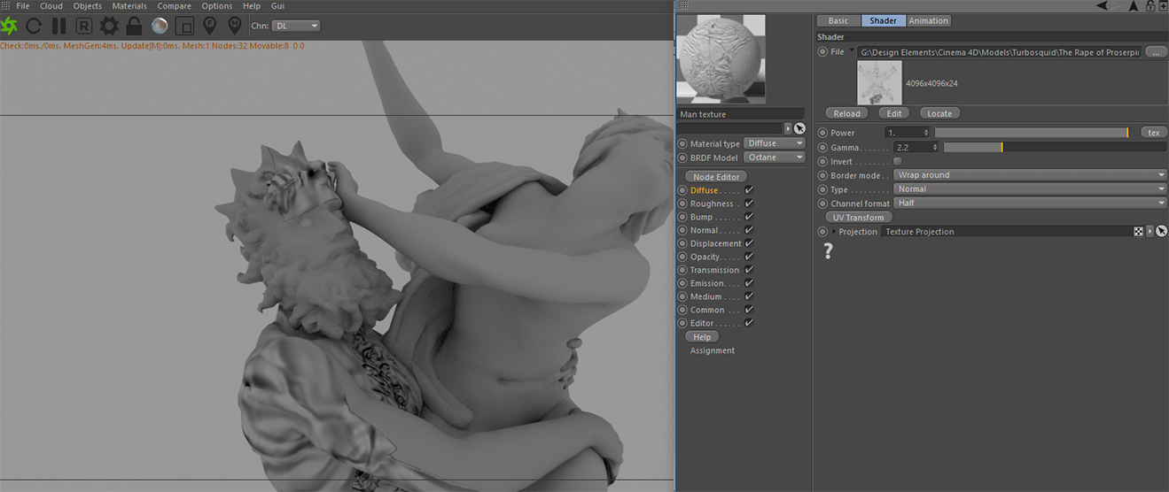

Not really sure where that is. Maybe you can point me in the right direction. Attached is what i have
TonyBoy
Posts: 238
Joined: Thu Dec 13, 2012 4:47 pm
That's awful, check things in BP Edit. The UVs don't seem to conform with the model.

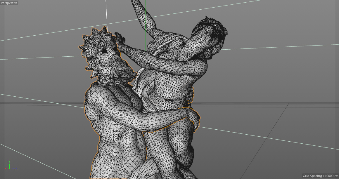

View the wireframe over the model to see what you have, Does it fit normally?
RouseandFable
Posts: 72
Joined: Sun Dec 21, 2014 9:09 pm
Looks like this
