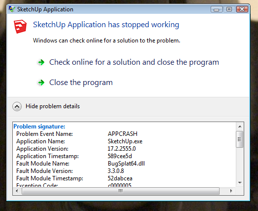

Thanks Captain for new update.....
But I´m back to bugsplat/crash every 2-3 min....
I shall update drivers +uninstall/reinstall.....

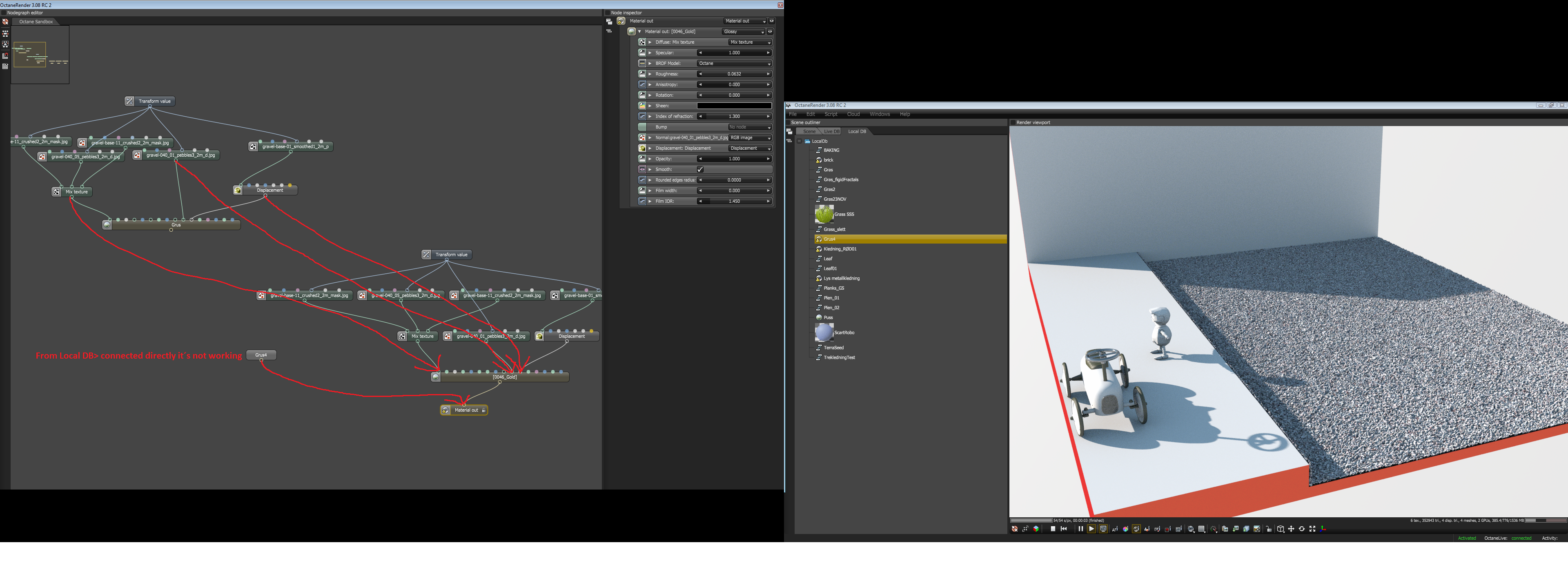

Cap, this was working in 3.08.0.9 ....(it´s not inside a proxy)
Now I have to connect as in picture, or it´s gone next time I open.

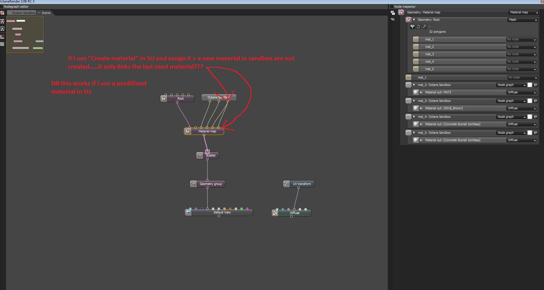

Captain, can you please explain this?

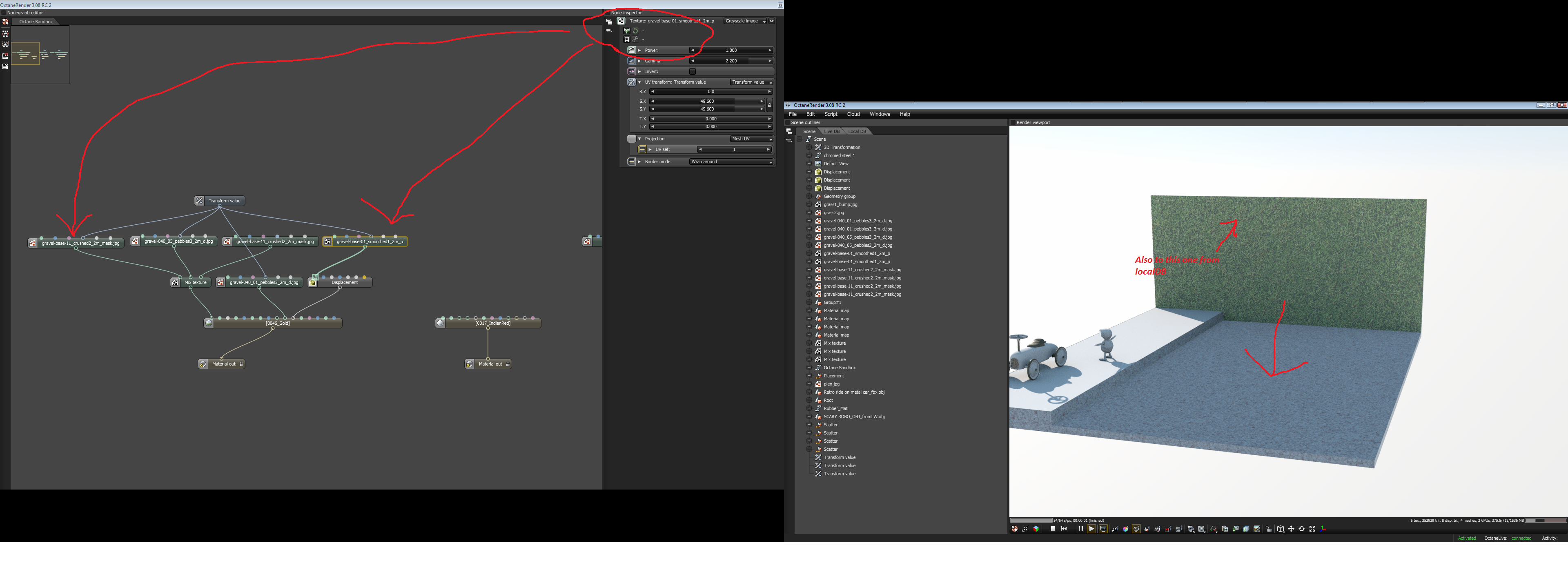

I think that if i chose a link path to my texture folder/structure> it should not be modified by the plug-in and cram every texture in one temp folder.
This are also a problem when exporting to standalone > I have to relink every texture

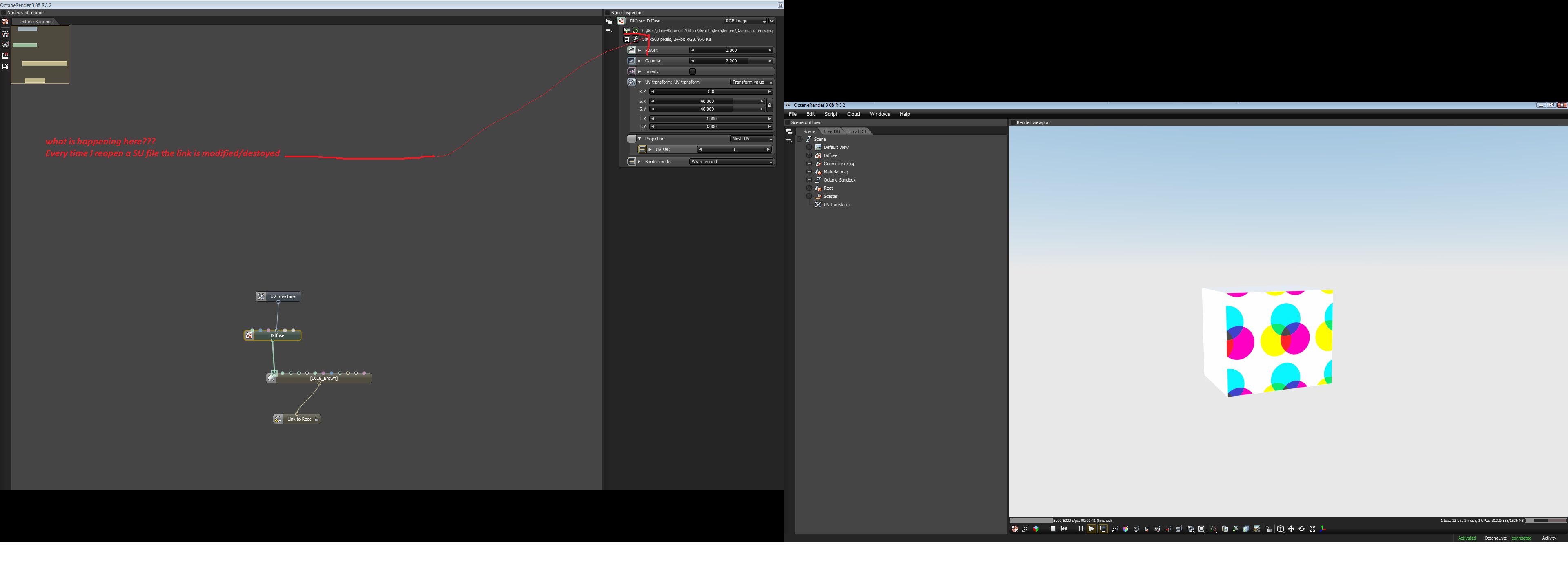

Grouping are not working
Grouping nodes in sandbox or main node graph> save SU document > reopen SU document = not longer grouped
