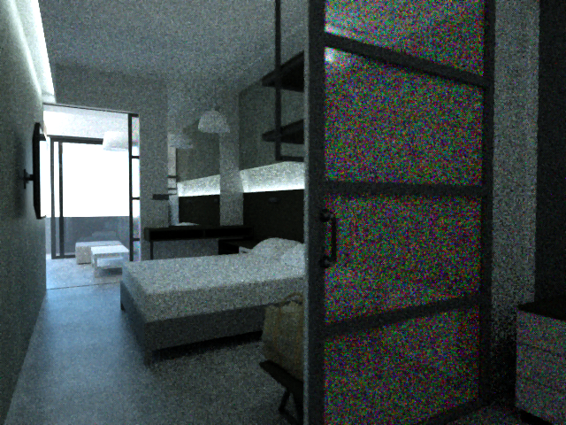

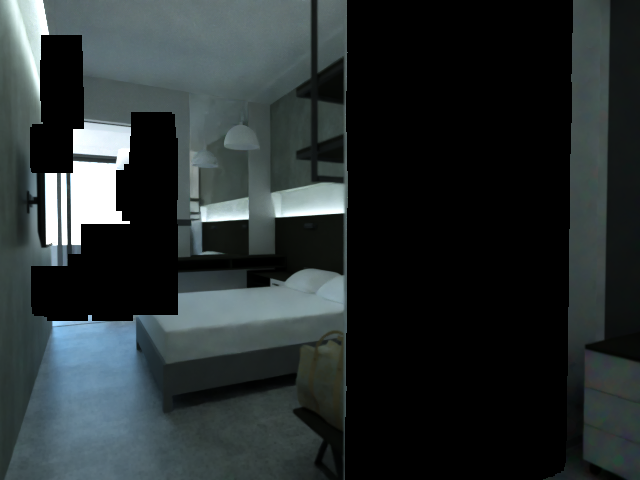

I am rendering a simple model with 4.0
On certain area surfaces with glass the doineser gives me black areas. Is there something wrong with the settings?
I tried with another material (plastic) and got the same results.....!
Thank you

What I did I increased the Caustic blare at the kernel and this solved the problem
I cannot figure out how caustic blare is related in general. In other words I have no idea.
What setting should someone have in caustic blare.
Really appreciate any help.

we found a bug in the denoiser code and will be fixed in the next release. I'm collecting scenes where denoiser doesn't work, I would like to have this scene for testing and add it to the training data if required. So if you can, please send me the scene.
