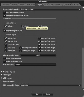

as it seems, that the plugin for sketchup never gets stabile (at least for me), i have to use the standalone version.
and one thing that frustrate me is, that the default material for obj files are glossy, so i need to select every single material and change them to diffuse.
would it be possible to add an default material option for obj import in the settings - like it's now added in the plugin for sketchup?
ps. i like the standalone verion :-) (apart from this material issue and the face that i can't lock a camera position - but that's an other story.)
thanks
jorgensen

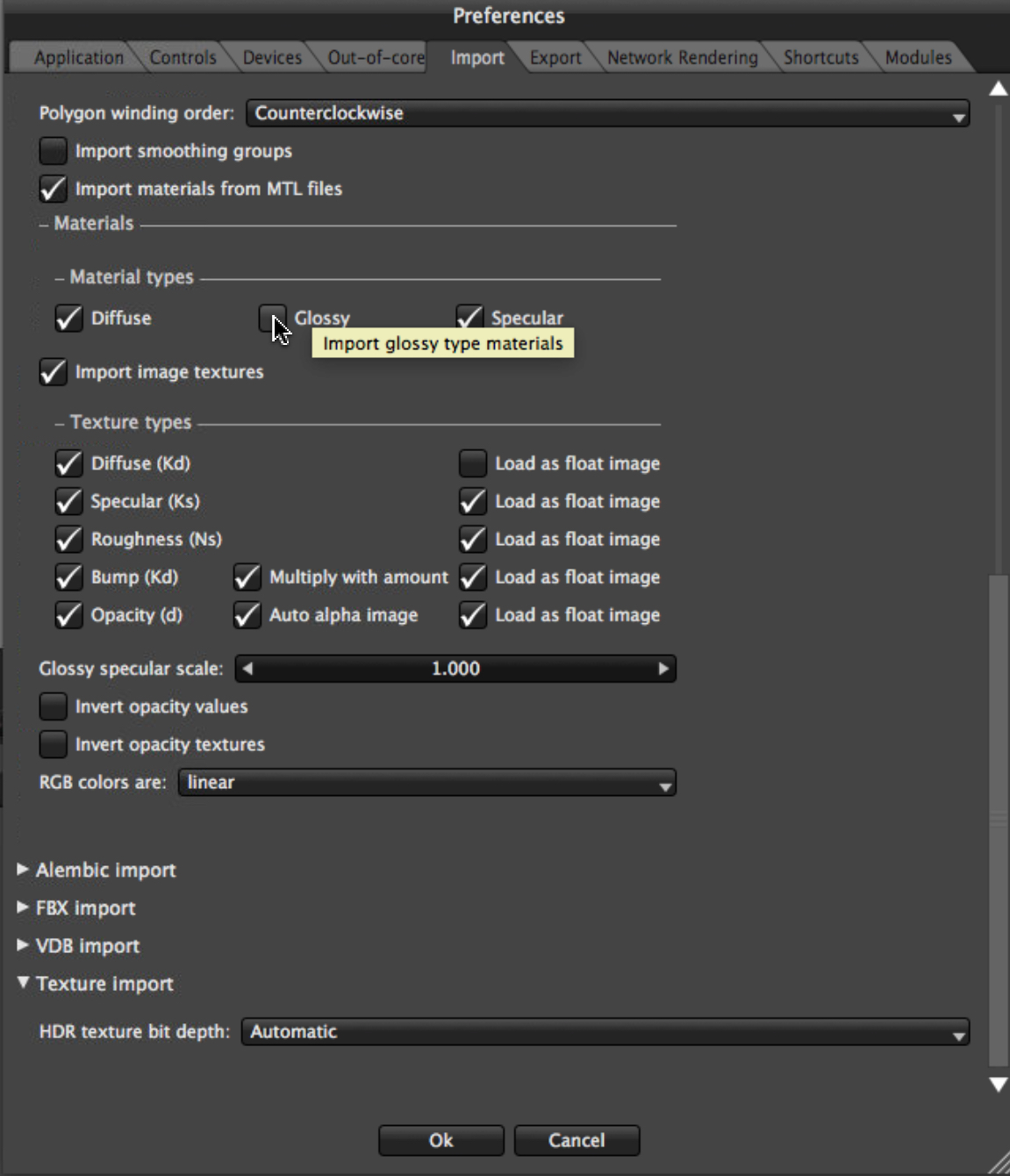

Posts: 10579
Hi jorgensen,
in Standalone Preferences/Import/OBJ you can specify some import preferences for obj materials from the .mtl file:
ciao Beppe
Jorgensen
Posts: 872
Joined: Sun Jun 30, 2013 10:53 am
a¤%#¤%?=)#¤%?= )#¤%=% doooohhhh - i missed the scrollbar - so i just saw the top of the iceberg :-)
thanks
