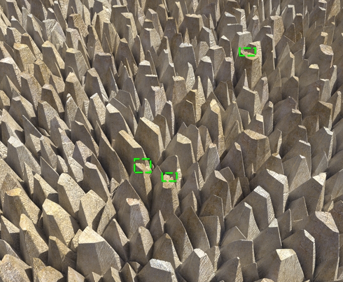

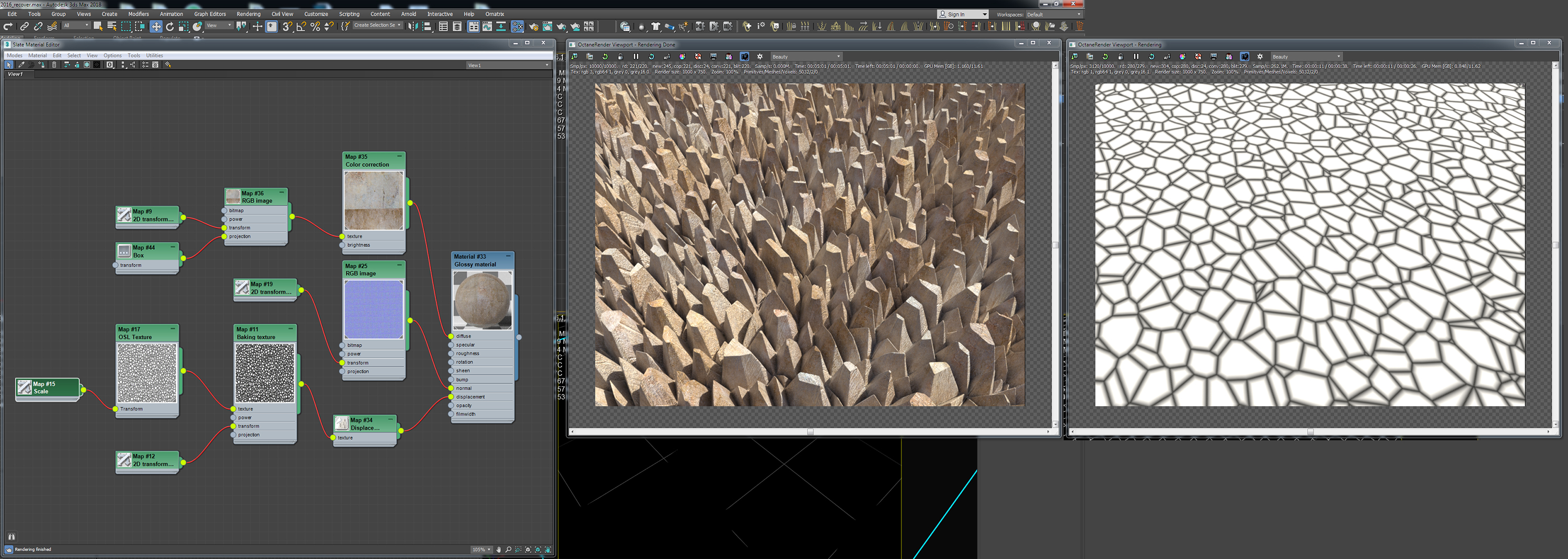

OSL texture voronoi edge distance using dispalcement and baking texture.
Thank to Roland for sharing.
Regards
Paride

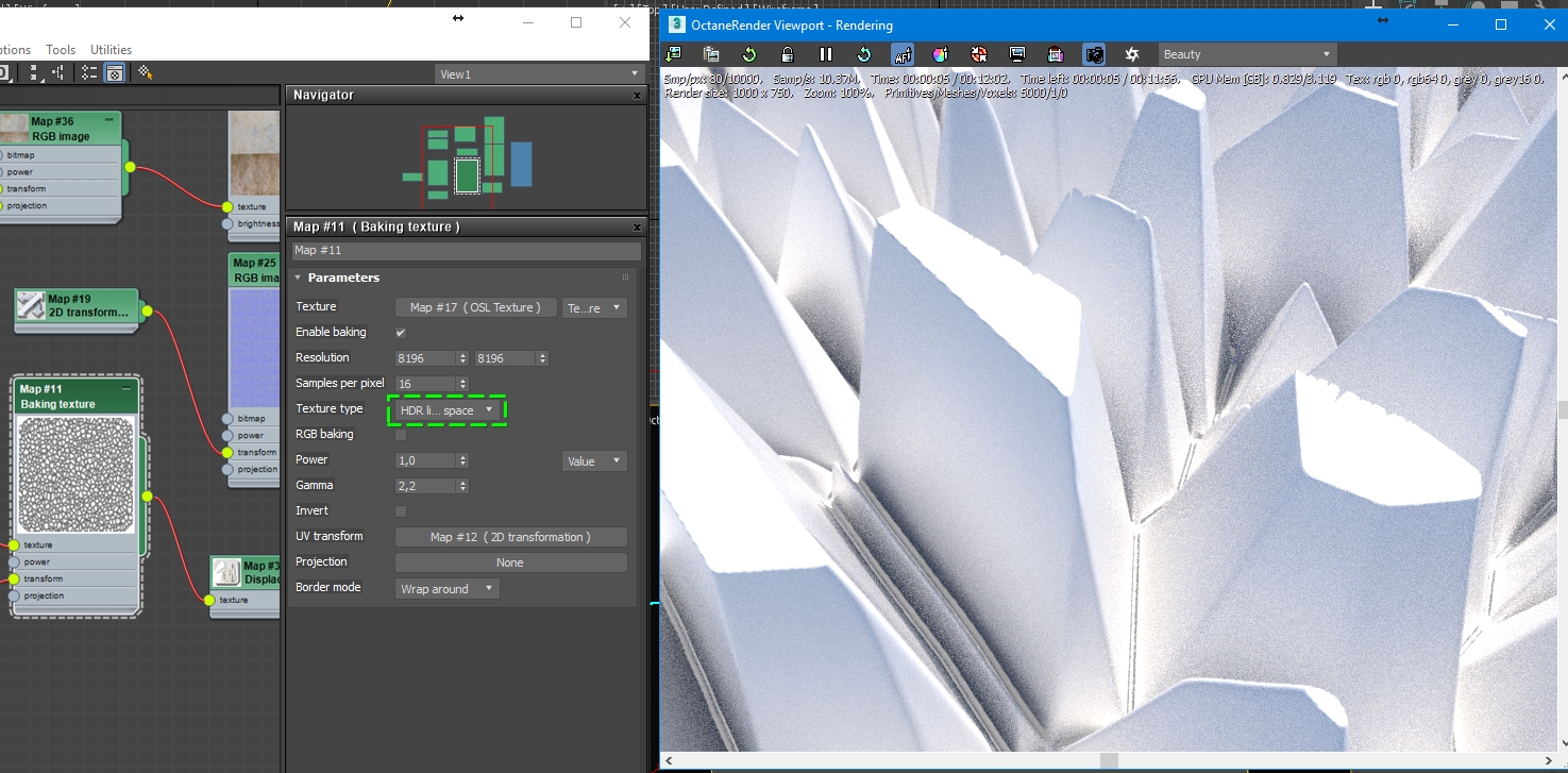

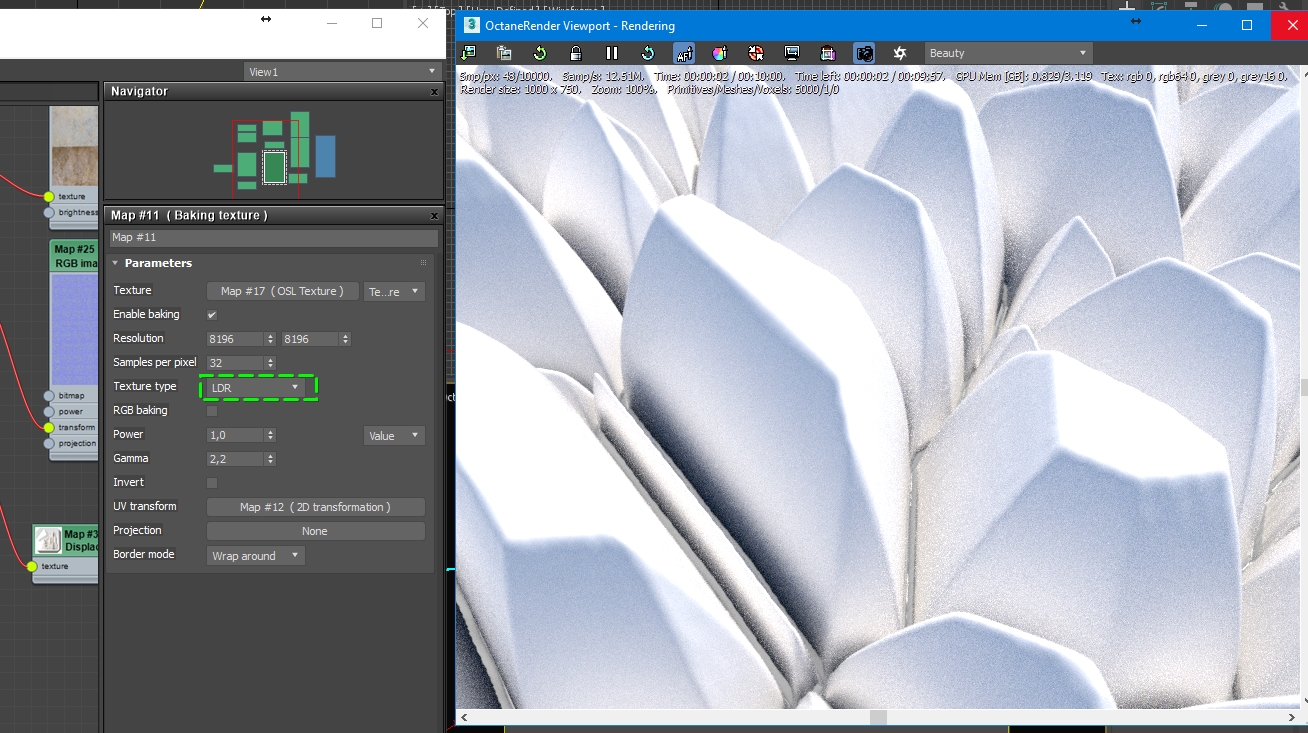

I still see here displacement old bug. Torn edges. Can you zoom your image, please?
Edit: I found that if change texture type to LDR, it fixes displacement a little bit.

Hi ramone163,
I'm making several tests in different situations, then I will report them to developers; said that a displacement issue, it does not depend on Octane 3dsMax plugin, but SDK.
Regards
Paride
Regards
Paride
