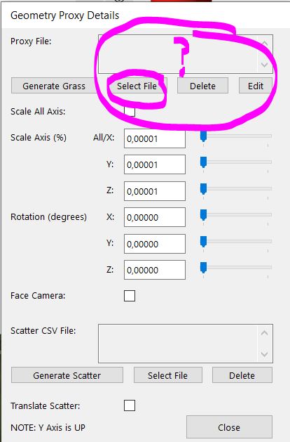

I was trying to make some proxies according to this tut:
https://www.youtube.com/watch?v=OEQfUOBAdS0

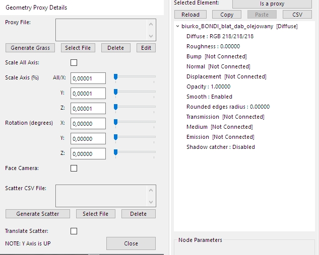

Attached proxied dosent apper on render - archicad object desappers. Proxy menue dosn't show file path and scale is ocward even if I change it its comming back to same state - see attachemnt. Dose anyone have clue what went wrong ?
I got error in cuda log during secen loading:
relative path with root given. Root '' will be ignored.

Hi, I have not seen these error before.
Could you pls send me the proxy file you are using and a simple .pla which reproduces that error with that proxy, and I will take a closer look.

I noticed the same thing two days ago.
When the model is loaded for the first time from the plugin all the proxies at the proxy tab show a scale of 0.0001 and the file path is empty.!!!!
The objects looks normal.
I have to refresh the scene for the proxies to appear correctly at the settings tab.
It looks like the first loading misses something.

Yes, I am having the same problem.
After selecting a proxy it does not appear in the window and therefor not in the render Window if it has nver been selected,
but hte archicad used for proxy is noit shown in the Render Port either.
After refresh the scene the proxies still do not appear correctly at the settings tab.
No error found in the cuda log. (?)
Running OctaneRender 4.02.1.91
Though, closing the Plugin and re open the plugin the proxies do appear as selected in the first place!
