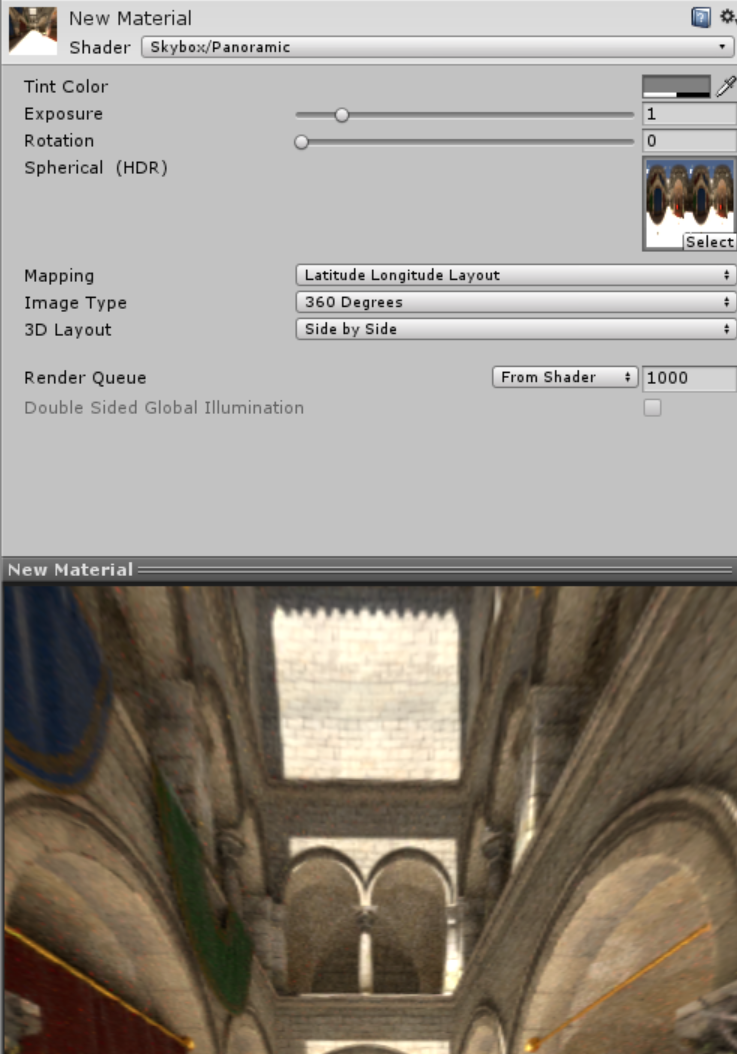

Yes. Unity 2017.3 and higher have stereo panoramic skybox material that can use Octane stereo panoramic renders. Seems that unity supports both side-by-side and over-under
Here is an example. Havnt tested it in VR yet personally.
More here:
https://docs.unity3d.com/2018.1/Documen ... ramic.html
