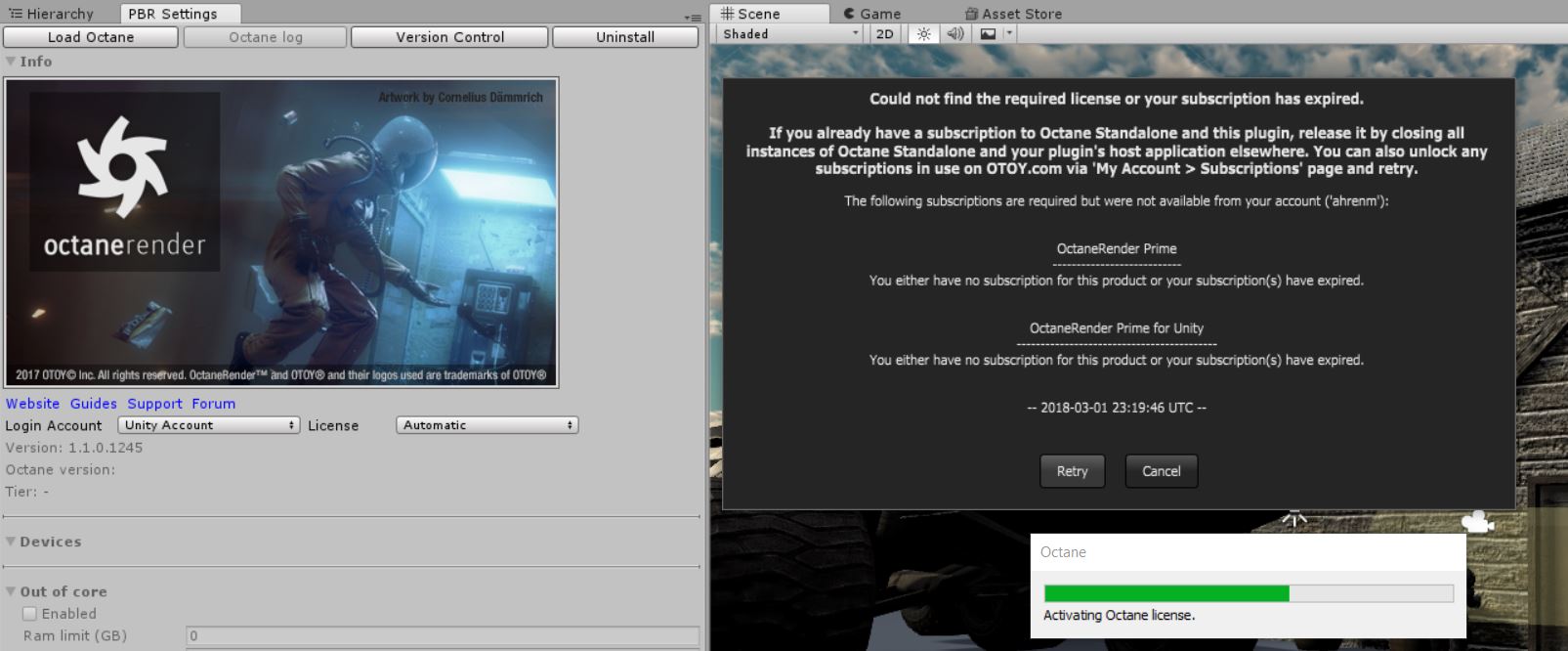

I recently had to downgrade from Unity Pro to Personal. Since then Octane says I no longer have a license I can use.
I've tried completely (including the "Octane" menu) uninstalling and re-installing. I can use Octant on the same cycle I installed it on, but as soon as I have to stop/restart Unity I get the no license message.
If I just remove the components from the project and re-install then no-joy :-(
Is there anything that can be done for this?

Is there anything that can be done to fix this? I've kinda been blocked for a couple of days :-(

Created a new account on unity.com and worked around the problem.

I did as well with new octane account one week ago but today again stopped working , same missing subscription plan in the website :/

alex_test wrote:I did as well with new octane account one week ago but today again stopped working , same missing subscription plan in the website :/
You also downgraded your unity account from pro to personal?
Are you getting error messages?
Could you PM me your unity account?
