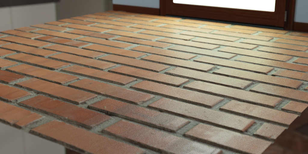

Some testing with the free version of friendly shade texture.
