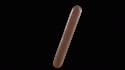

I am trying to blend between 2 materials. And mix materials sound like the logical and only option to do that.
Sadly i ain't getting the result i am looking for.
As you can see from the gif i have attached, i want to blend from a RAW state to a Grilled state.
Having made a RAW material and a Grilled material i now try to blend between them using the mix node.
The problem is that it gets brighter before it gets darker again.
I belive this has something to do with both materials beeing 50% each in the middle of the transition.
Does it exist another way to blend them? like have the other material ONTOP of the other?

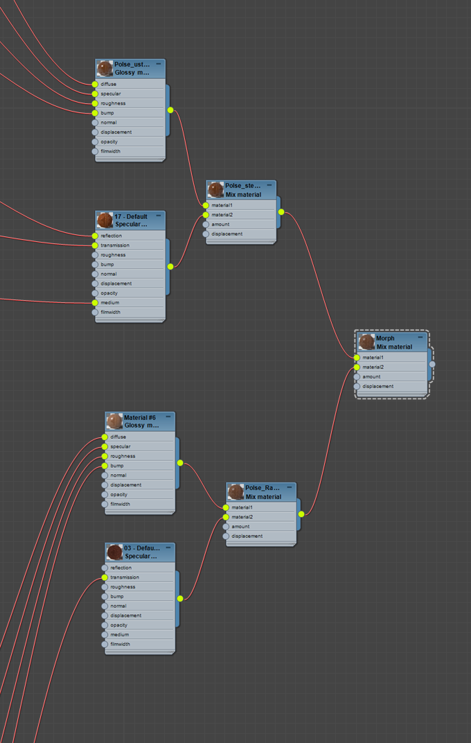

After digging a bit more it seems to be somewhat connected to the SSS (specular) material.
As you can see on the picture i added.
I have a "raw" material and a "grilled" material. each of these compose of a glossy and a specular material that is mixed with 0.4 value.
If i turn these mixes to 1 so only the glossy materials is in effect and animate the "morph" mix node from 0 to 1 the colors/brightness animate as expected.
If i keep them at 0.4 and animate the morph node it gets that increased brightness before it goes dark again.
a solution might be, instead of having 2 separat materials like now that i try to mix between, i just have 1. and animate all the different values and blend all the different maps innside that one shader.........but that sound like a painful job.....

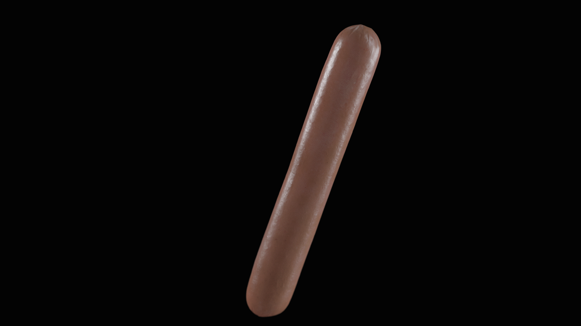

Hi Stir,
this is using only mix material, changing specular in 2 steps.
Regards
Paride
Regards
Paride
