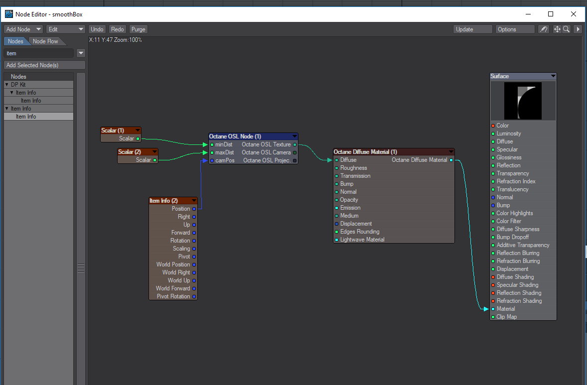

Hi all,
There's been a couple of requests for fake fogs and distance dissolves recently. The best I've come up with is a simple OSL node that creates a texture based on distance from a given point:
Just connect scalar nodes to the max and min pins and any vector input to the camPos pin (this example uses an item info node reporting the camera position, but it could be a null, or anything else for that matter).
Anything closer than min distance gets coloured 1.0, anything further away than max distance gets coloured 0.0, and anything in between get shaded linearly.
You can use this texture directly on any colour pin (as shown below), or on an opacity pin, or on the Amount pin of a material mixer node to create fake fog effects.
Have fun!
James.
