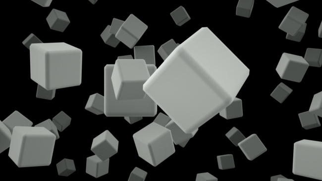

You can use this texture directly on any colour pin (as shown below), or on an opacity pin, or on the Amount pin of a material mixer node to create fake fog effects.
Have fun!
James.
