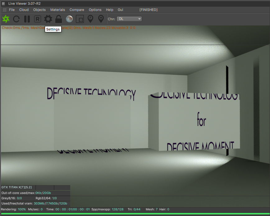

I would like to project an image (text) on a cube and the behind wall, but don't want the part of the image which is on the front cube also on the wall.
I try the baking camera with no result.. Please help !
See attached C4D file
Many thanks

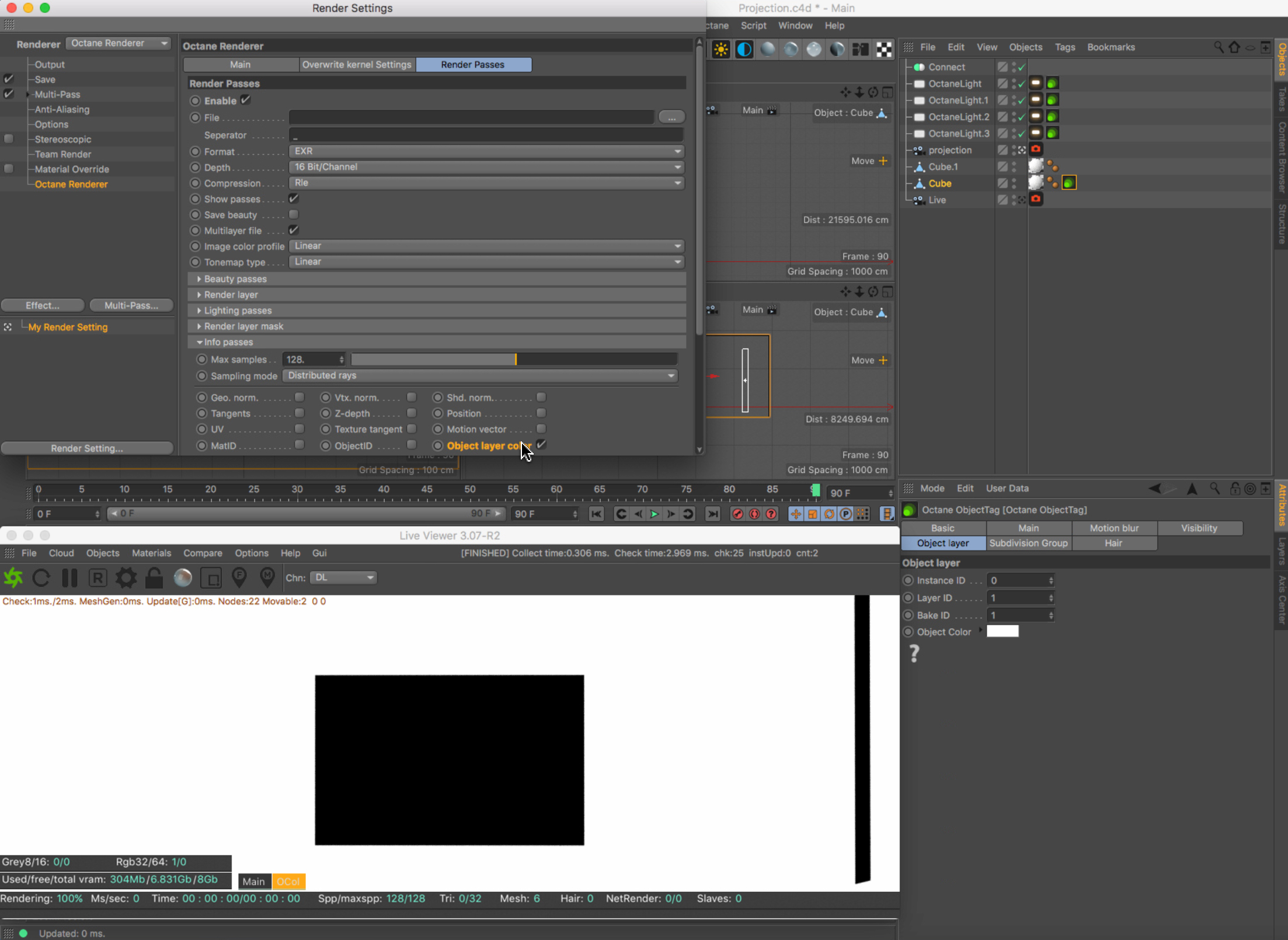

what about changing the object color to white, of the general cube, in order to obtain the desired mask with an object layer color pass? But it’s not completely clear to me what do you want to obtain, sorry :roll:

I want something like that, the sentence is correct only at the end of the camera movement.
= A projection that stop with the objet in front (the cube)
Is is more clear ? An idea
Thanks !
