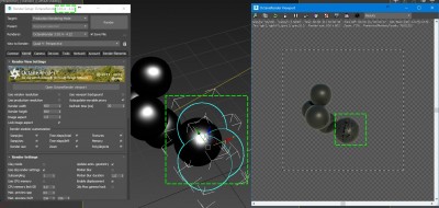

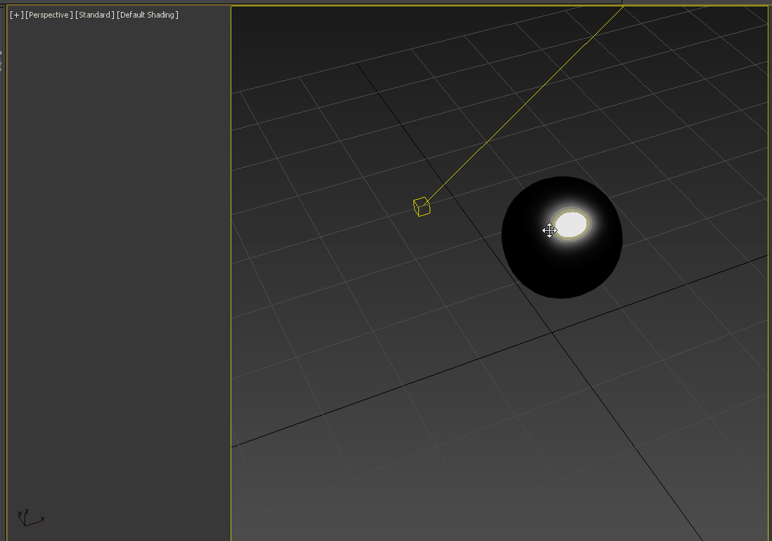

The object is animated with Visibility.
In the isolated mode, everything is ok. When visibility is 0, we do not see the object, when visibility is 1 - we see.
But in normal view and render when visibility is 0, we still see the objects. Why? Please fix this.
I tried version 3.03.3-4.22, Animation works fine, but still some problems on render. I think somehow hidden objects with a visibility=0 affect on other objects.

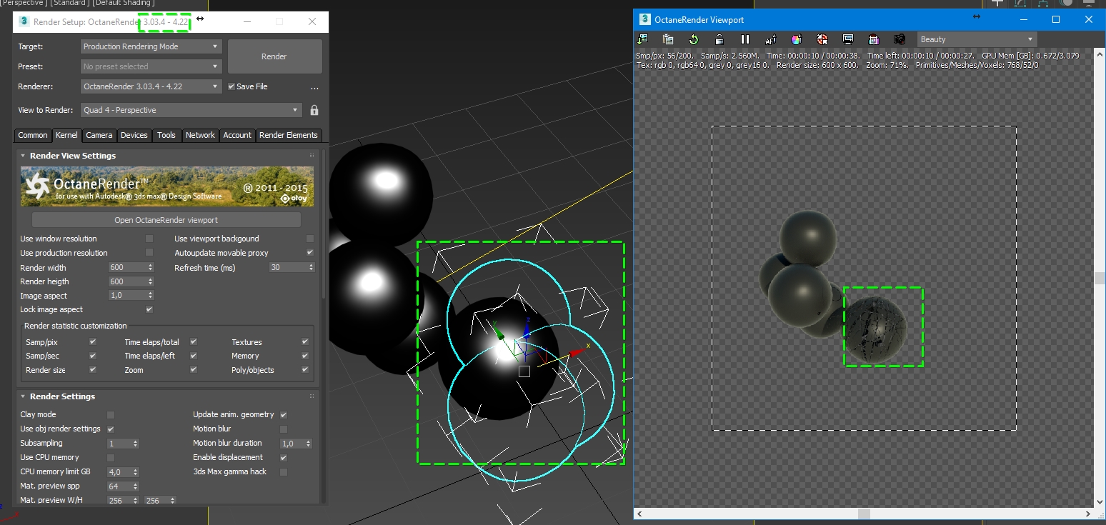

Hi paride4331
Please check my scene.
1) Render frame 1, you will see that we see all object in the render, but must be only one object.
2) select all balls and remove MovableProxy and render again. You will see one ball but with cut lines, like hidden objects cuts this ball.
Your visibility is made with material opacity, right? My is made with object visibility options. (This animation is baked pFlow)
