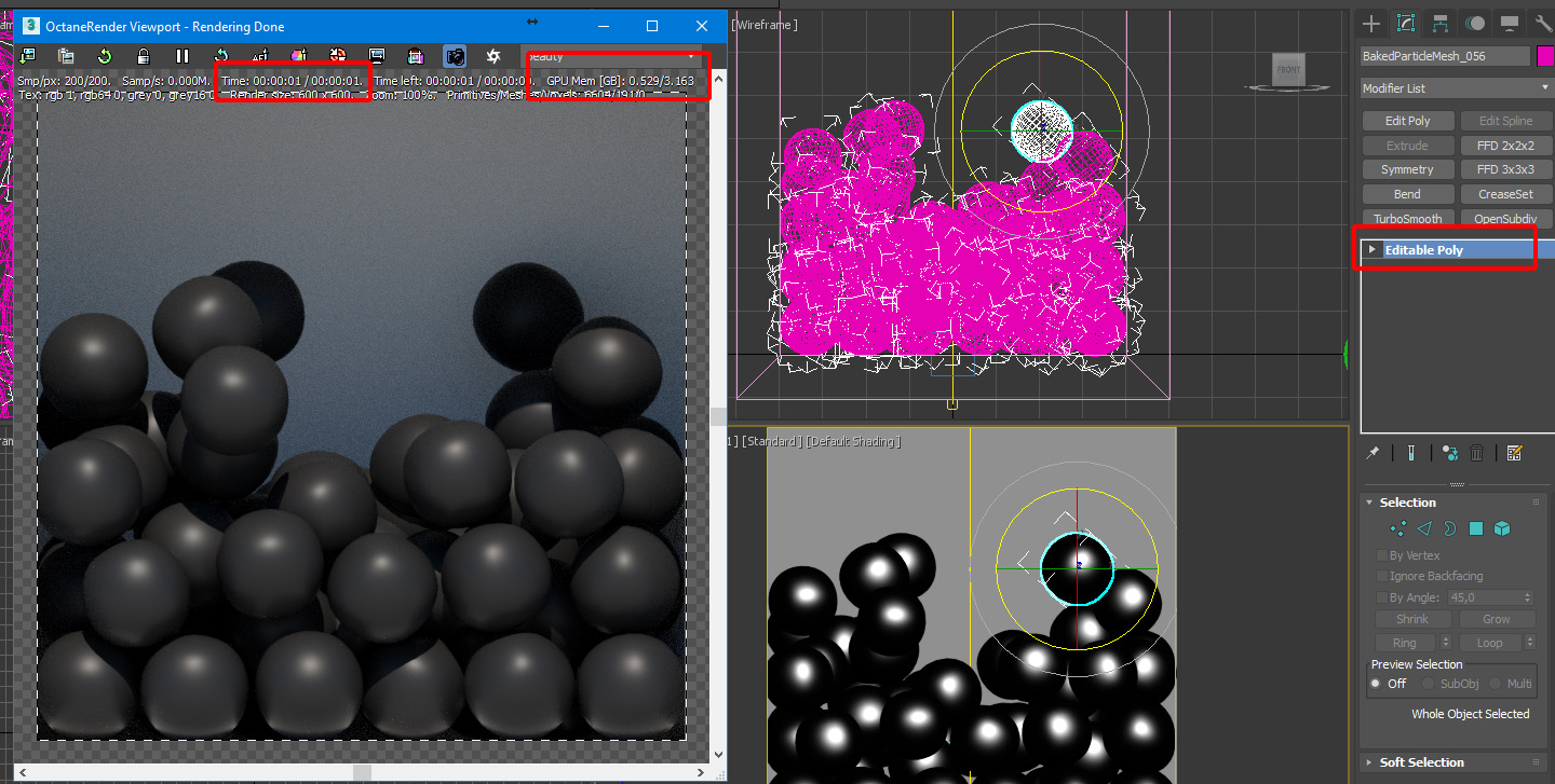

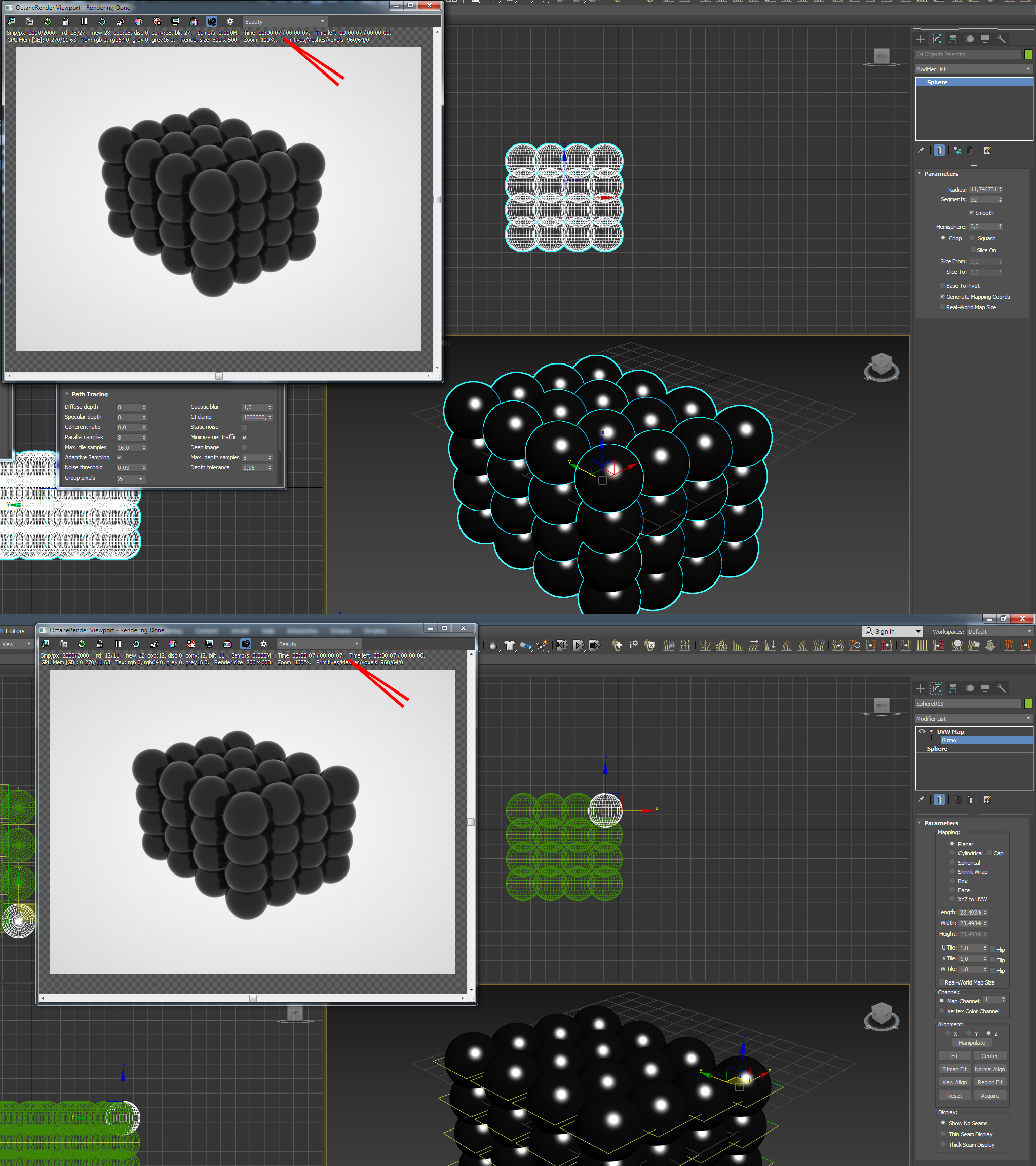

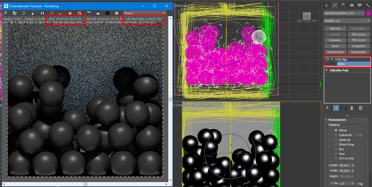

Everything rendering fine. But when I add UVWMap to all objects, evaluation and render time is x20 time slower. But GPU mem used is same: 0,5 Gb.
Can you please fix this.
Check my images:
instances + UVWmap render speed problem

I think you just selected one ball and added UVWmap? Try to select all balls and add one UVWmap.
Please check my scene:
Try to render for example frame 50. Then select all balls and delete UVWmap and render again. You will see the difference.

One more thing in my scene:
1) objects are instances with MovableProxy - render time 1 sec
2) objects are unique with MovableProxy - render time 10 sec
3) objects are unique without MovableProxy - render time 4 sec
