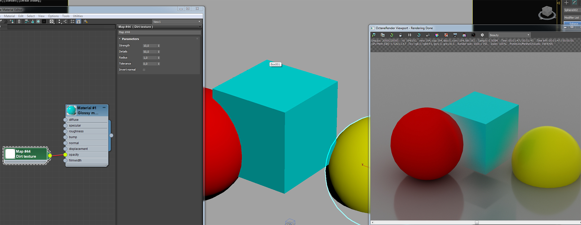

Do any of you know how to dissolve an surface by its distance to an object?

paride4331
Posts: 4004
Hi ruuterdetuuter,
a simply trick could be to use dirt map node in opacity slot.
Regards
Paride
