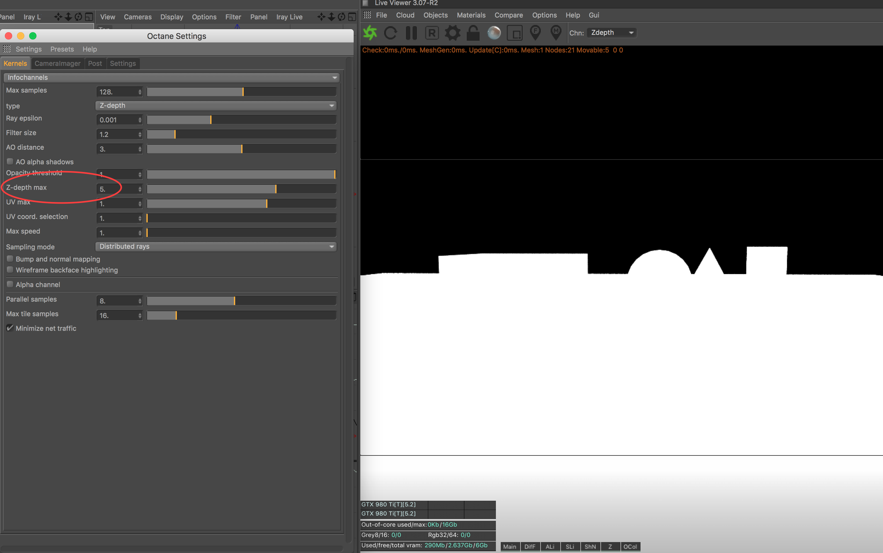

Sometimes z-depth renders out as solid white and sometimes it renders out fine. I can't figure out what I'm doing in one file that's making it work/not work.
The really odd thing is that the z-depth shows up looking totally fine in the octane render view.

It always works but you need to know tonemapped vs linear difference. See end of render passes in manual. There's a video to show usage of zdepth in AE.
It does, if you switch your render to info channels you'll see there is a Z-depth slider, if you increase it it will increase the distance of the z-depth pass. Sometimes (depending on the size of your scene) you'll need 1 but sometimes 50 or even more. Also take into account that on the render settings you must go to octane passes and set that number on the z-depth slider (it's at the bottom) to the same number you've chosen on your kernel settings.
