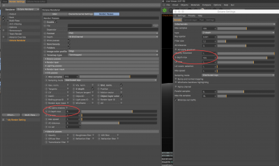

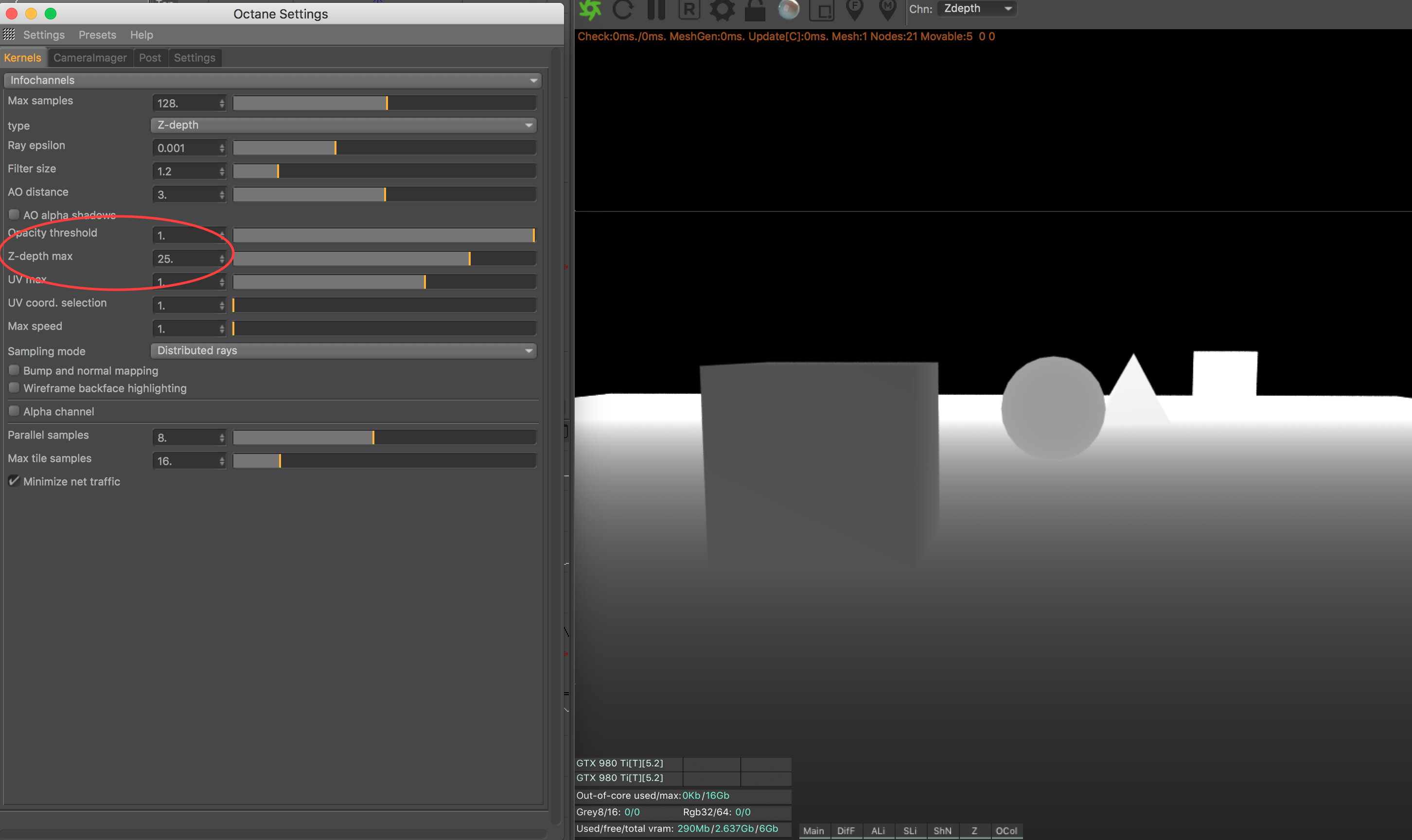

It does, if you switch your render to info channels you'll see there is a Z-depth slider, if you increase it it will increase the distance of the z-depth pass. Sometimes (depending on the size of your scene) you'll need 1 but sometimes 50 or even more. Also take into account that on the render settings you must go to octane passes and set that number on the z-depth slider (it's at the bottom) to the same number you've chosen on your kernel settings.
