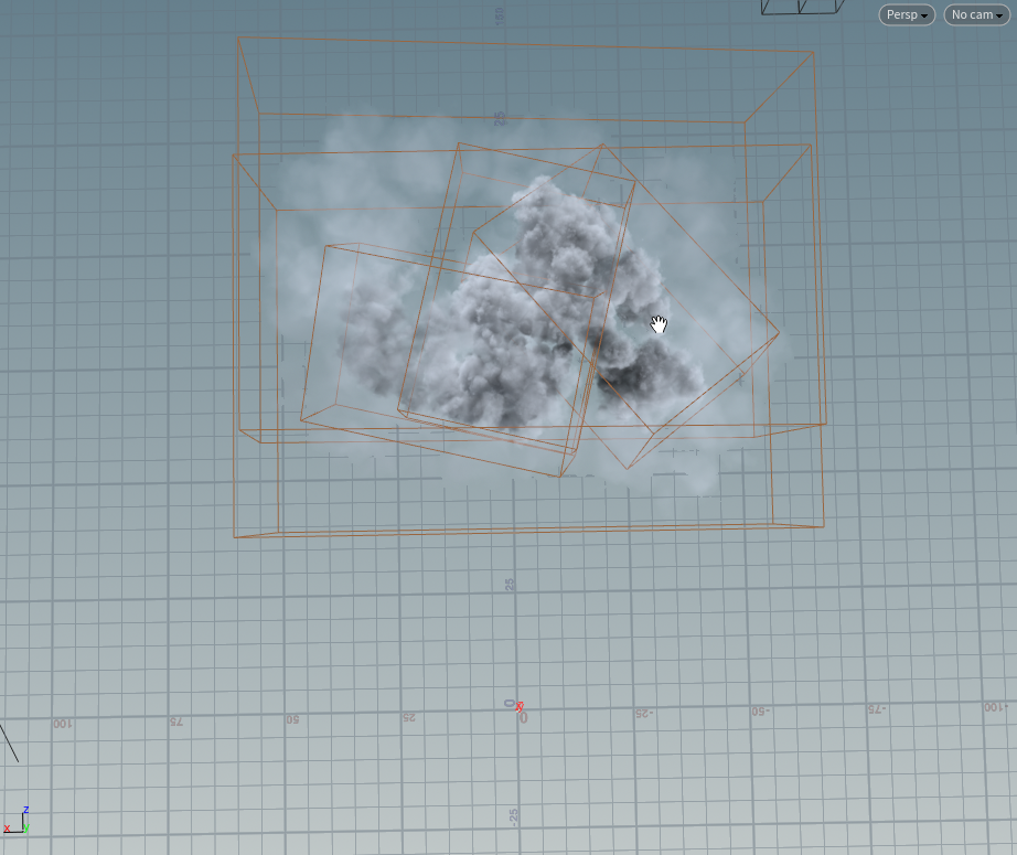

Hi, i have a problem with houdini and c4d regarding vdbs. As i import the VDB in c4d, i m missing all the grids from houdini. This cloud is consisted of 5 grids and while in vdb loader says they are there, i see only one of em. See images below.
What is the solution for this?
Houdini with 5 different grids

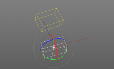

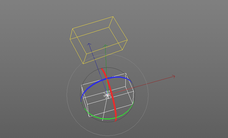

I see only 1 both viewport and render

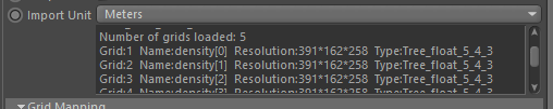

says that 5 boxes are loaded

Try to export each grid as different vdb. You can't have multi grids in volume object.

Thanks, good to know. We merged all vdbs in one grid from houdini eventually.
