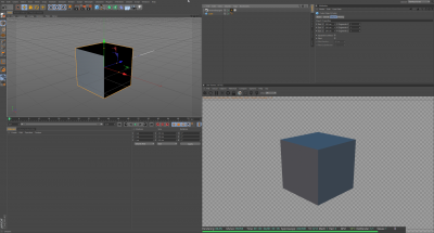

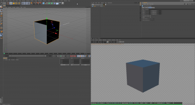

Hey, something weird has happened this week with my network render setup. It's all been in working order until a few days ago. I noticed my render node wasn't actually being used, even though it was online and connected. I did a few tests to find out what it was, and it turns out it stops working at a higher poly count (not even high, like 200k). What are the potential culprits for this? I have restarted everything, updated to the newest for each, new ethernet cable. It just shows NetRender 0/1.
I have also noticed even when it's showing that it's working, like with only a cube on screen, it doesn't seem to actually be performing faster. Any help would be greatly appreciated! I'll attach a screenshot to show the difference in just a cubes poly count.

Thanks for the reply! I did see the new "Bind all" option in the new one, which is great! Sadly it hasn't helped me in this case. I can still have it working with just a cube there, with confirmation that the slave is online and running. It's just with any actual scene it seems it can't handle it? But that's never been the case before. So very confused what changed.
