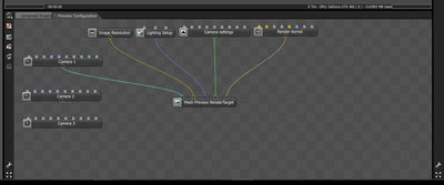

On the subject of cameras you can of course create additional camera scenes by adding extra camera nodes in the preview render tab, then connect each node in turn and then adjusting the camera position for that node,then move on to the next node and repeat.That way if you want to set up say 3 or 4 or more views in a scene with your file and return to them later if need be.
Please see attached the default set-up that I have saved that loads every time I render a new job.

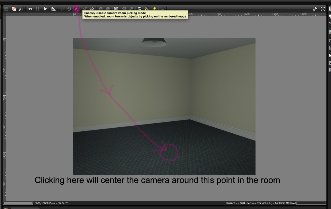

You need to use the Camera Viewpoint centering tool on the tool bar.Use this to click on a point in your scene where you want the camera to centre upon.The Camera will then re centre itself so its viewpoint will swivel around the point you just clicked in the scene.If it is not quite right first time then use it and zoom in to that point then repeat again from that point in the scene until you can pick out the swivel point around which you want the camera to point to.
See the attached screen grab of an empty room as an example.On first import my camera in this scene ended up outside the room.Firstly i used the tool to centre the camera on the outside walls of the room.Then i used the mouse scroll wheel to zoom in through the walls of the room.Then i used the tool to pick out a point in the centre of the floor of the room around which the viewpoint could swivel.
You can walk your camera through a multi room model this way using the picking tool and the zoom wheel of the mouse.

Hi Jaberwocky,
I have tried your test-scene and did some tries with my scene also. Now I understand what was wrong! It is not very easy for me to find the right point to click to get my camera moved as in your scene. BUT it is a giant step better than before. Now I can work with it! Thank you so much! Also many thanks to Tig as well.
By the way, may I ask you another question: I wonder why your example-room is "visible" inside although there is no light. I have tried a similar test-room-scene yesterday and recognized that behavior also although I did not have windows in my room. In other renderers it would be dark.
yannic
