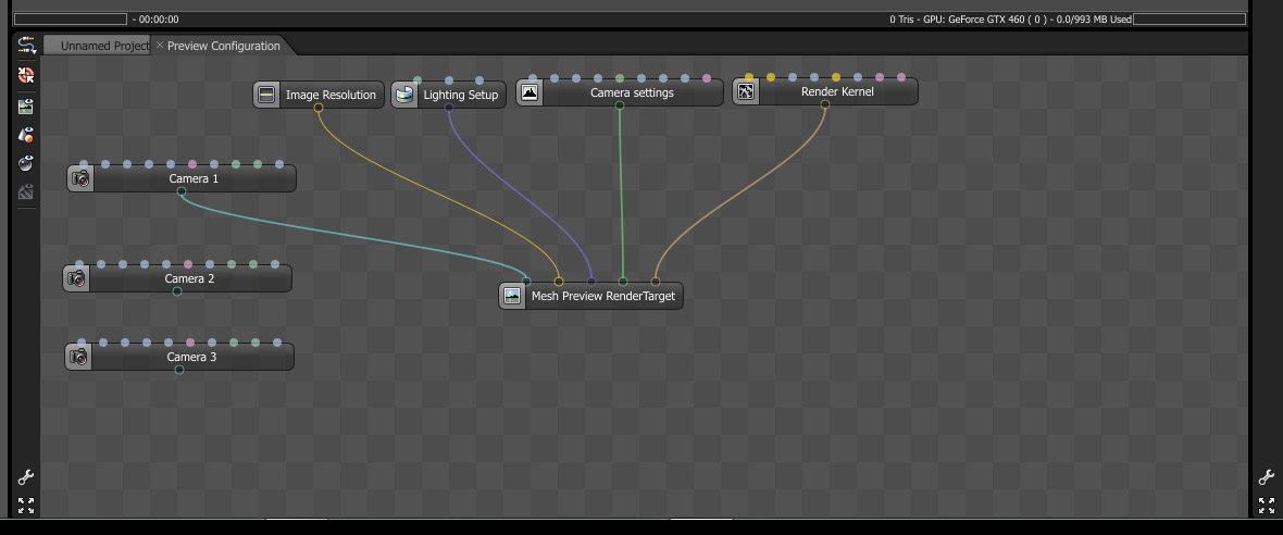

On the subject of cameras you can of course create additional camera scenes by adding extra camera nodes in the preview render tab, then connect each node in turn and then adjusting the camera position for that node,then move on to the next node and repeat.That way if you want to set up say 3 or 4 or more views in a scene with your file and return to them later if need be.
Please see attached the default set-up that I have saved that loads every time I render a new job.
