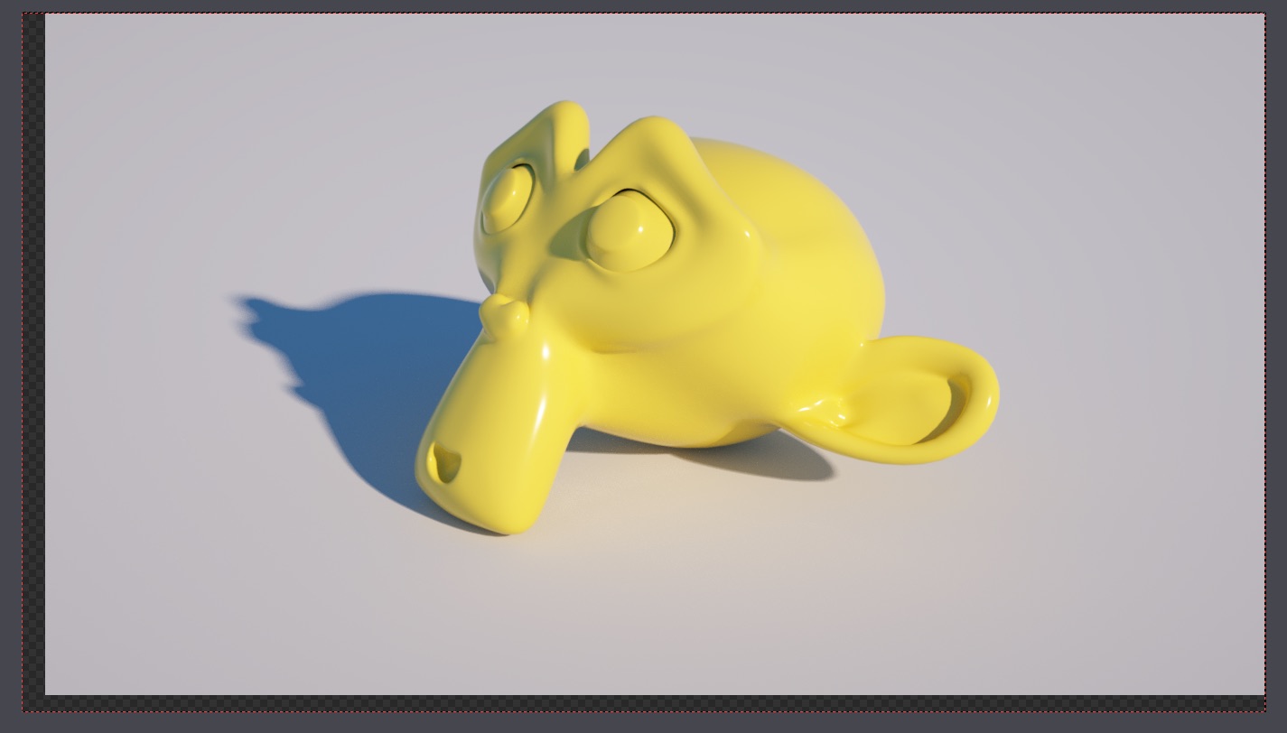

It's not ok DrawFun. Take a look at attached screenshot. There is an empty margin on the left and the bottom edge. Moreover when render border is enabled it renders to infinity ignoring the number of entered samples. This happens only when interactive preview is enabled. Final render is ok.

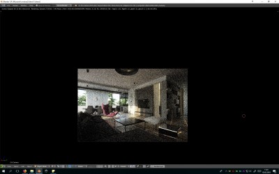

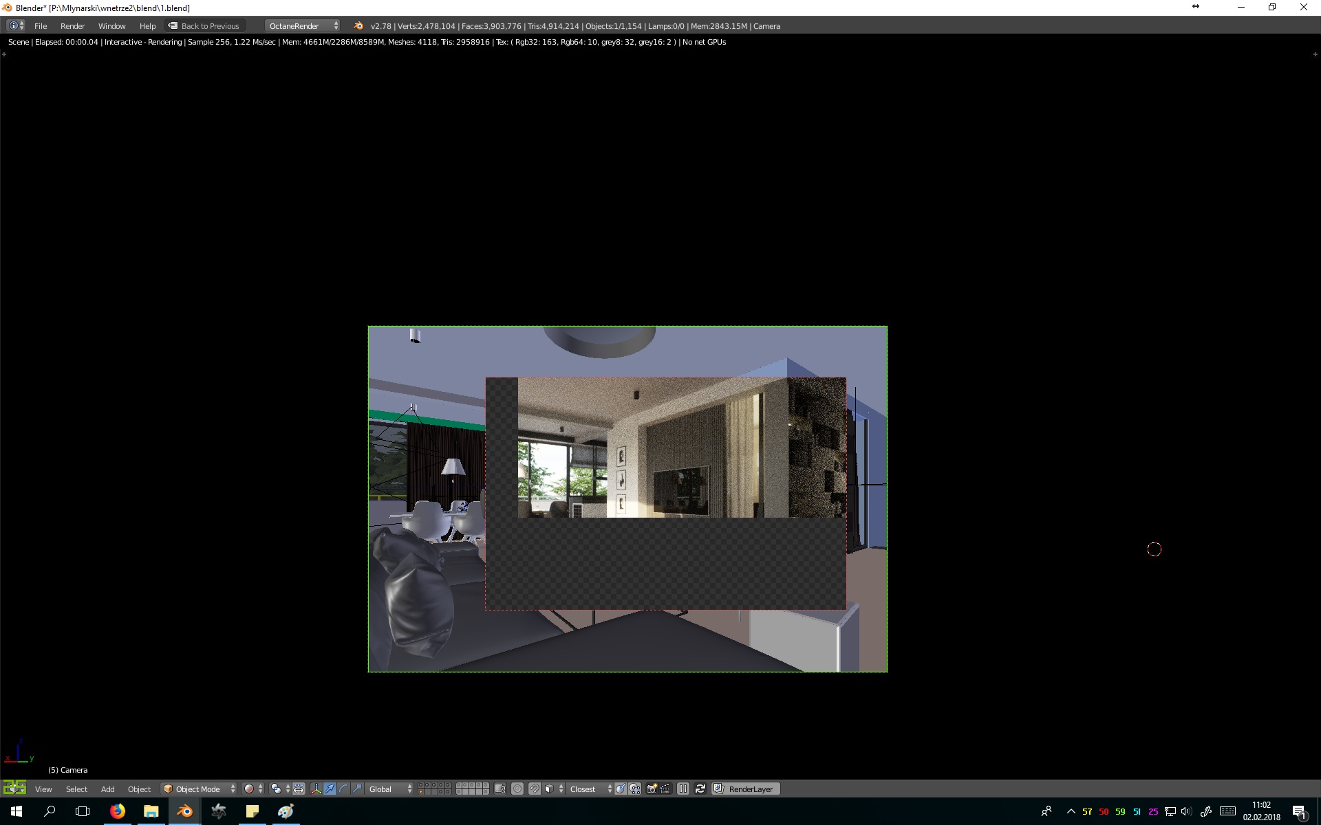

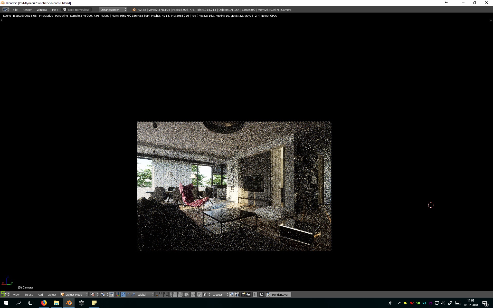

I'm attaching screenshots to illustrate the problem. It occurs only in Camera View. On one image border is disabled, on the second - enabled. Any border render in viewport, camera view, is deficent for me.
