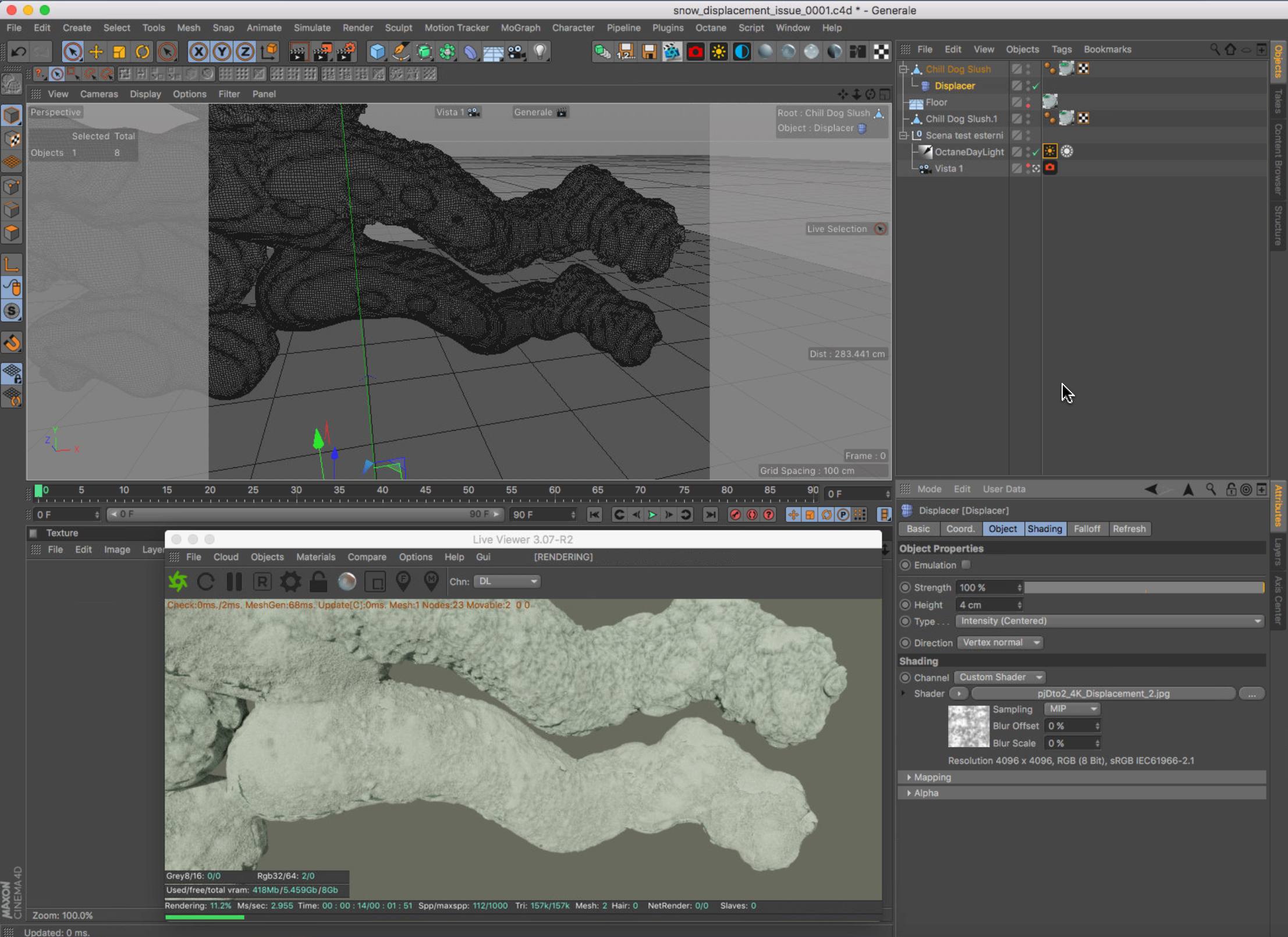

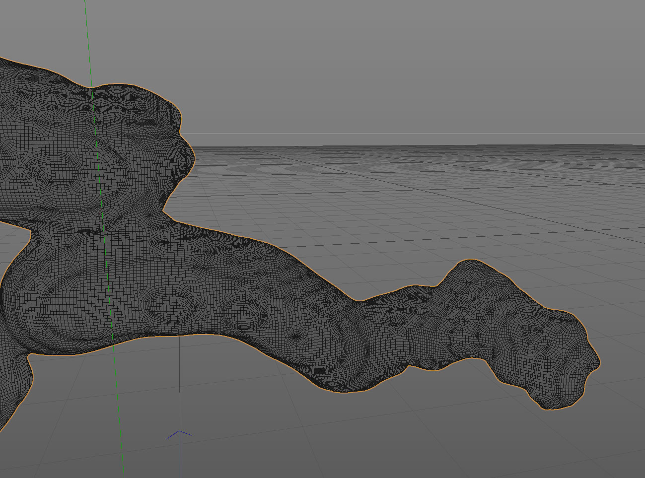

I know the problem was already seen and discussed, but i want to be sure that in this case is not my mistake and is a real displacement actual limitation of Octane.
I need to realize a "realistic" snow, so I have my mesh (see in attachment the scene) that is not planar and where is really difficult to make an UV mapping.

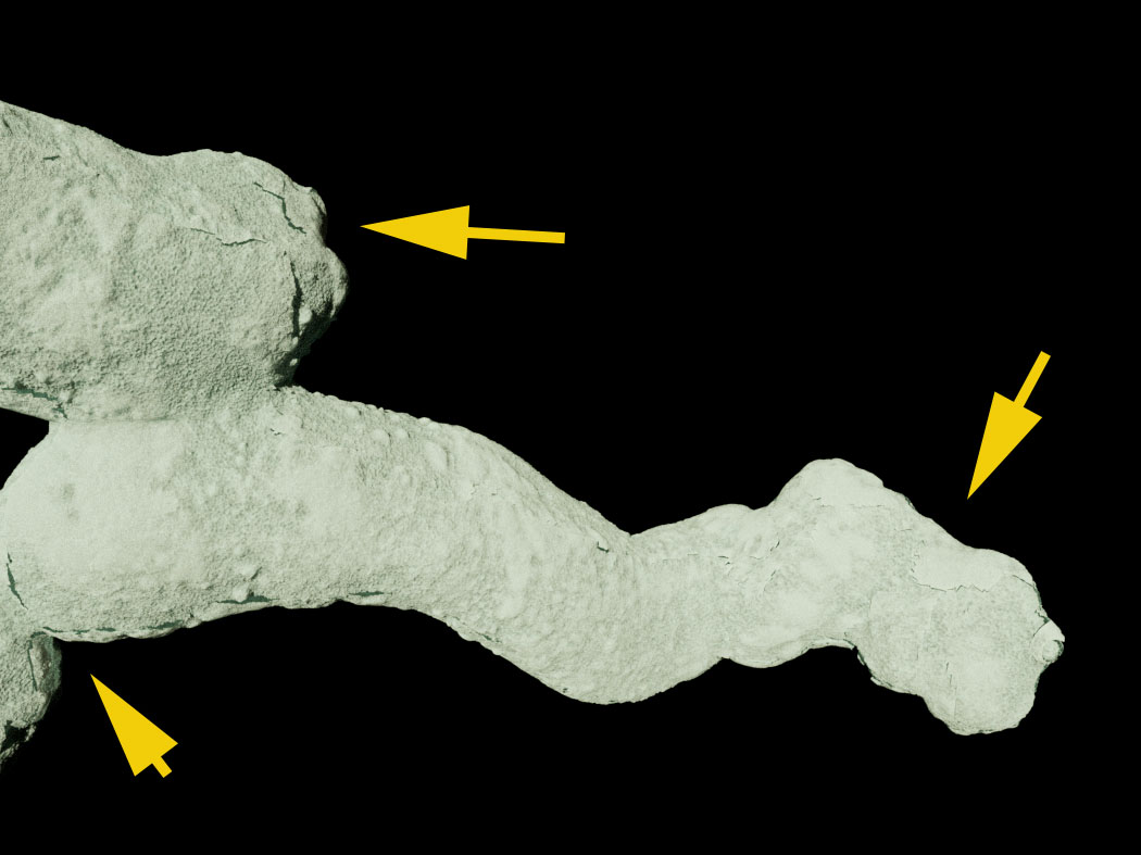

I've tried a hundred of solutions (textures, phong angle, mid level,...) but I have always the same problem: broken polygons.
So I ask and enclose the scene to see if someone could give me some tips in order to resolve.
snow_displacement_issue.rar
(40.33 MiB) Downloaded 169 times
i9-10900x, 96GB DDR4, 2xRTX 2080 TI, ASUS X299 SAGE, Windows 10
http://www.visual4d.it
Posts: 10626
Hi Luca,
with a such dense mesh, it does not give any advantage to use the Octane displacement.
Look at what you obtain if you use the same map in the displacer deformer:
You should reduce a lot the mesh to take advantage of Octane displacement, in my opinion.
