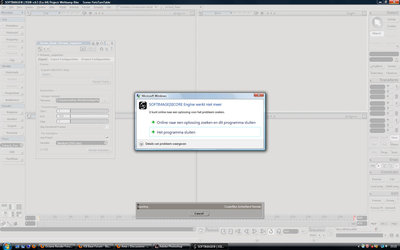

It is not the voxelation what is the problem. The export from XSI just freezes halfway through, still in XSI, Octane not even started. Here is a picture of the problem. In this example it froze quite early, couse the model was now 3.5 mil polies for rendering in MR. Normally, an object with 2.5 mil pollies stops about half way.

Maybe you can zip the Softimage scn file and send it to me via pm?
The problem is, i don´t have the 6.5 installed.
There are major changes between XSI 6, 7 and 2010-
