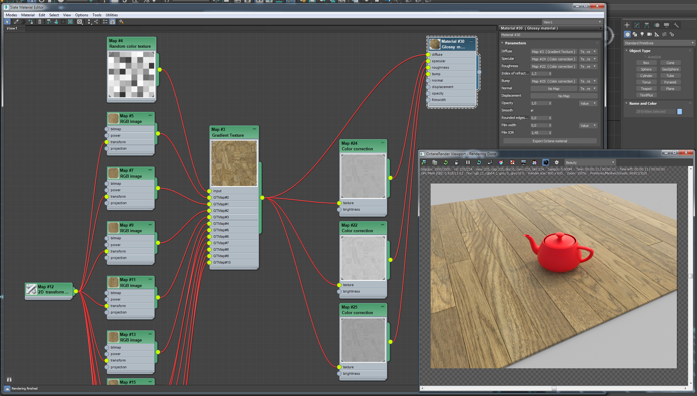

Is there a way to apply random transforms to a material?
I have a map showing a bunch of wood. I want to apply this to a load of fence panels and have it not look like the same map on each panel. I've not been able to work out how to move the map up and down (offest?)random amounts.
Is this possible?
It' seems to be available on C4D but I can't get it working in Max.

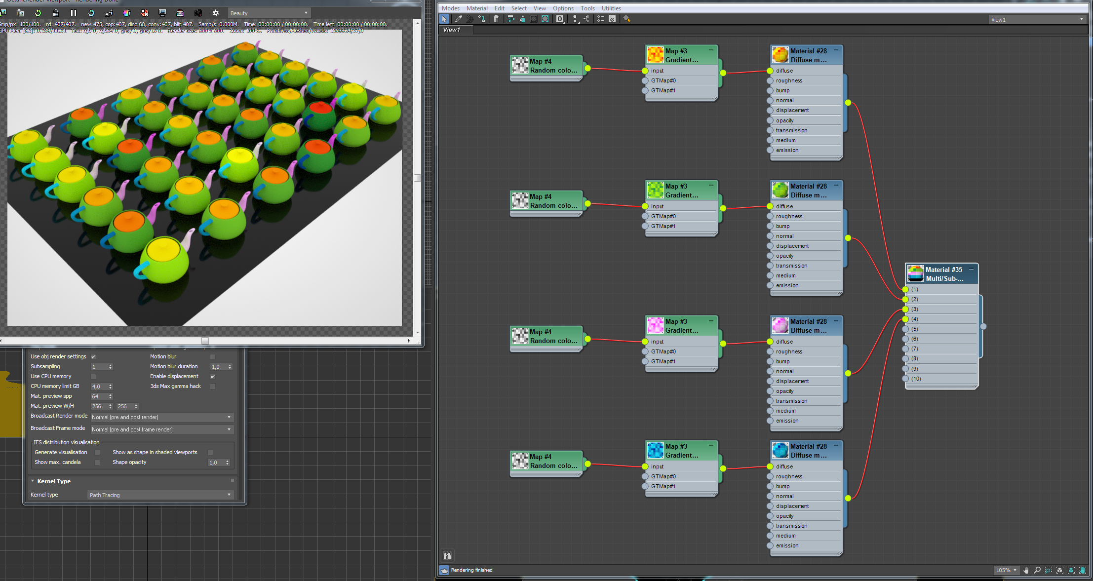

Hi Rik,
try this.
Regards
Paride
try this.
Regards
Paride

- paride4331
- Posts: 4004
Hi Rik,
yes, it is from 4.39
Regards
Paride
Regards
Paride
Hi, Paride,
This is great but you need to have separate objects to do so.
It would be top to random not by objects but by elements.

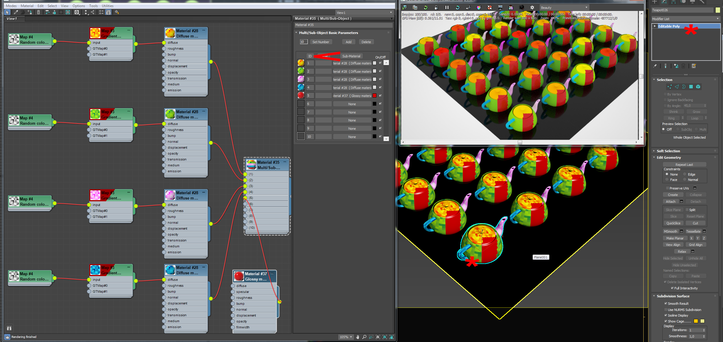

- paride4331
- Posts: 4004
Hi HHbomb,
something like this?
Regards
Paride
Regards
Paride
- Attachments
- 01.zip
- (434.76 KiB) Downloaded 666 times

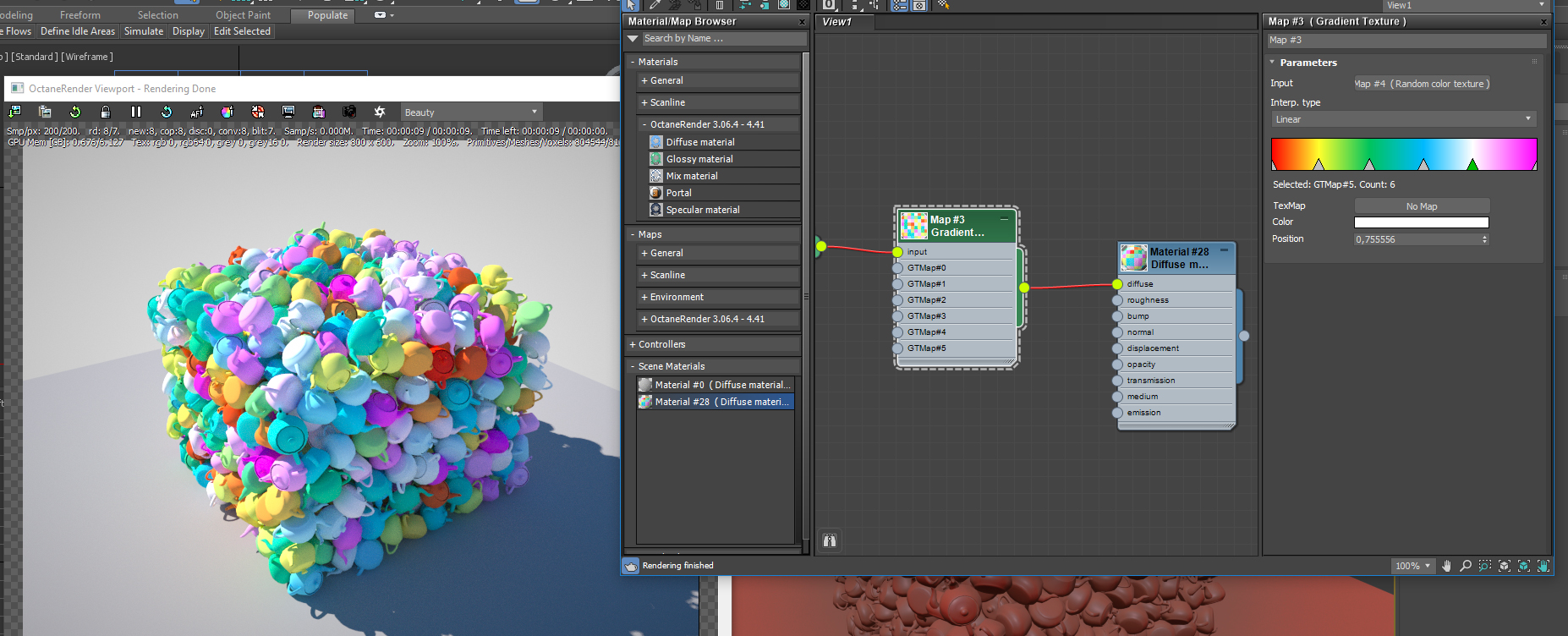

MatIDby element ?
What I want to do is randomize color of one ID by element : randomize color of leaves of a tree that share same ID. I am still with 4.41
If it is with 4.42 ( instance range and color) I am very interested in infos how to use this with 3dsmax version.
One more question: is there a way in max to display gradient ramp larger than in slate material window ? When I have a lot of values, it is a pain to select them.

Hi Paride
So how would one use this for...
1 randomly changing the hue/saturation/brightness of different leaves on a plant
2, randomly changing the overall hue/saturation/brightness of the whole plant so all instances of it don't look the same
3 doing this to our library of octane proxys.
