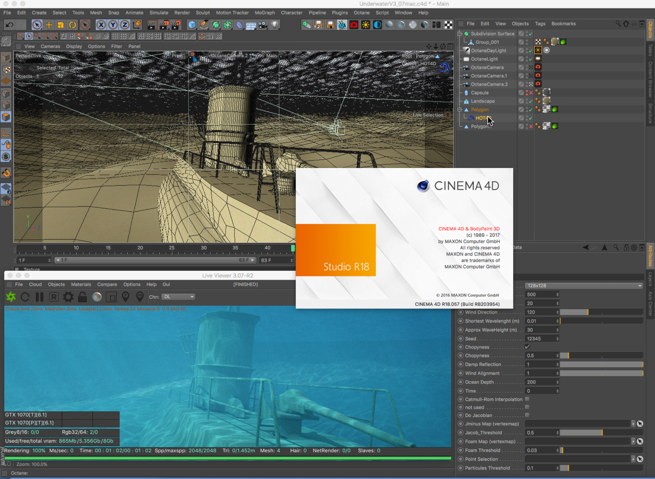

Hi bertritude,
here it seems to work properly in R18:
What kind of issues are you having exactly?
