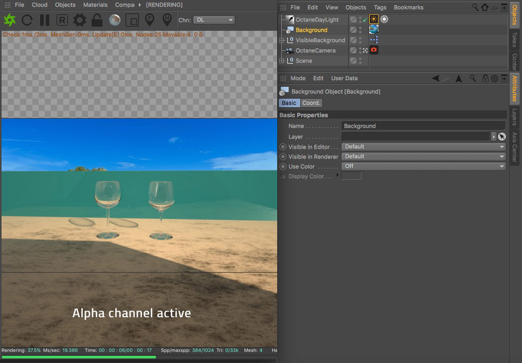

If the Background c4d node is used, it is necessary to enable the Alpha channel option in the Kernel settings, but the Background image is not taken into consideration in reflections and refractions:

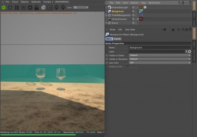

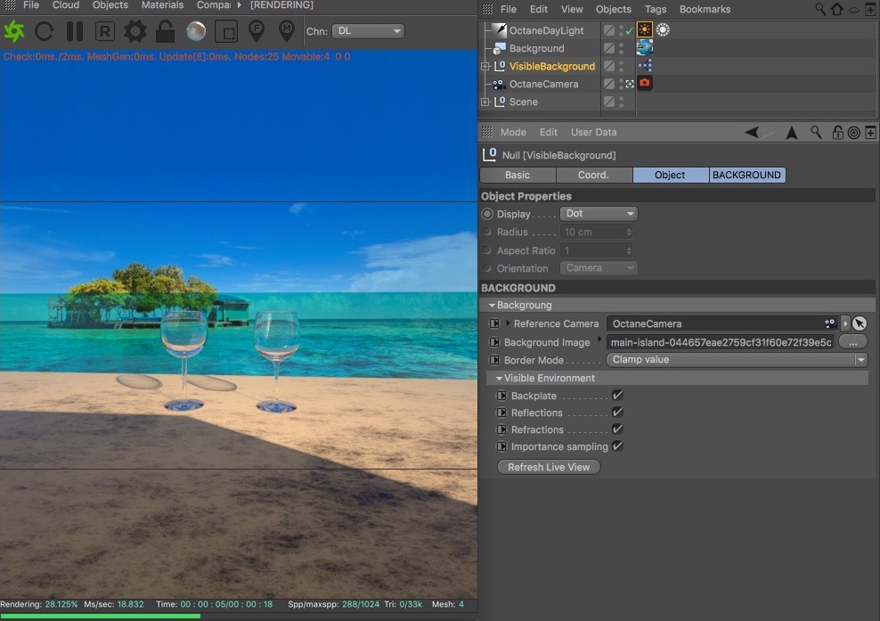

With the VisibleBackground Xpresso setup, you need to assign a reference camera, and the image to be displayed as RGB Image texture node. In this way, the projection and uv transform node of the image will be adapted to perfectly feat to the frame buffer, taking count of the camera FOV and Shift value:
It is possible to enable/disable backplate, reflection, refractions:
And change the border mode, in order to have different reflections/refractions based on the color repeted in all directions in the Visible Environment node:

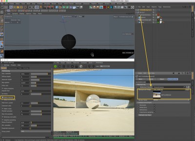

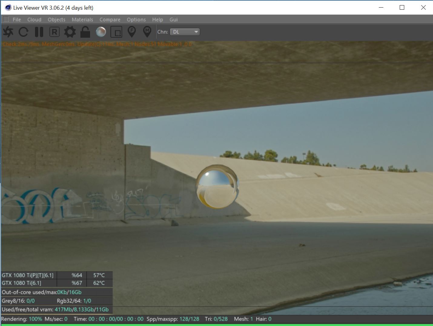

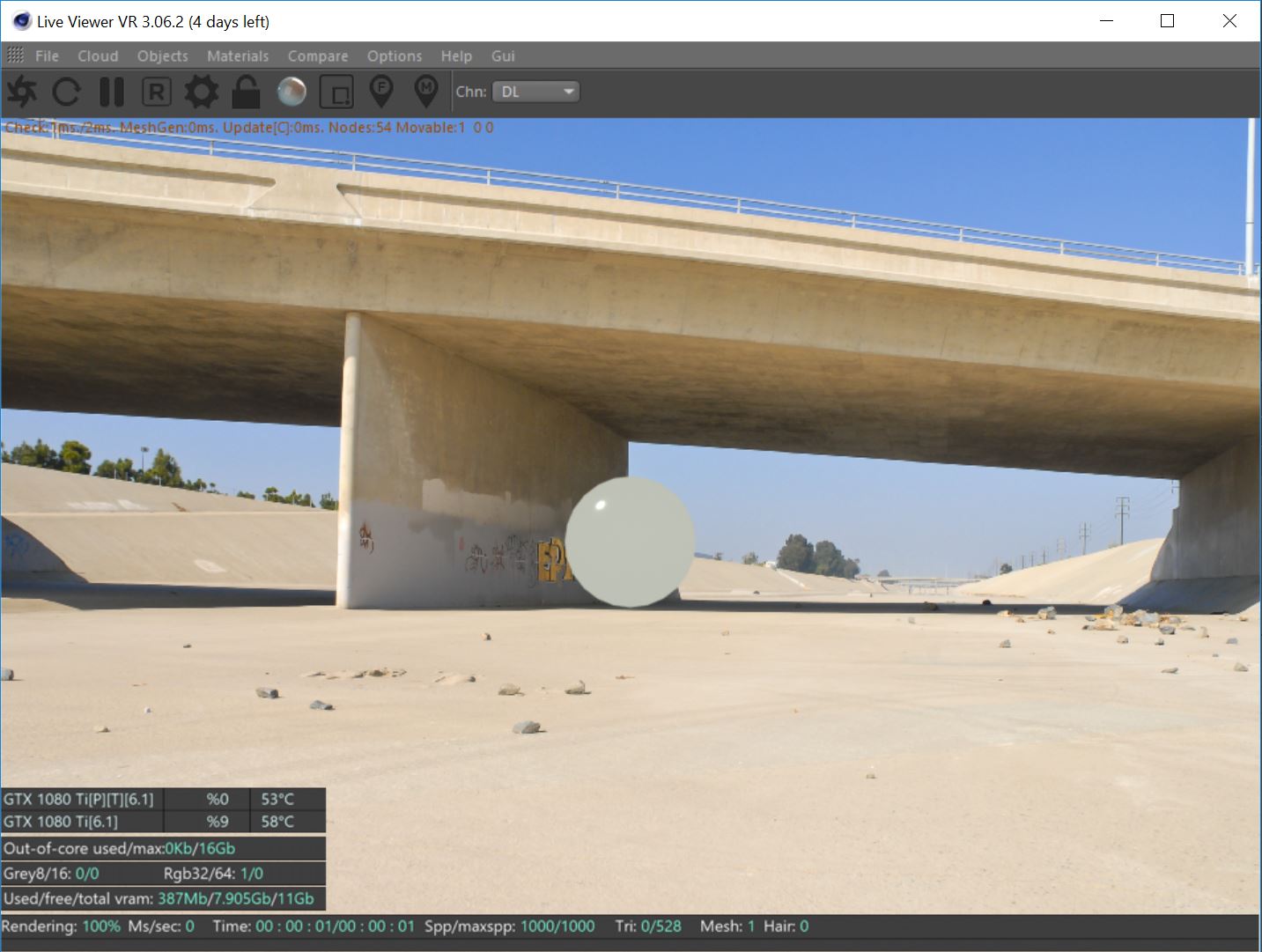

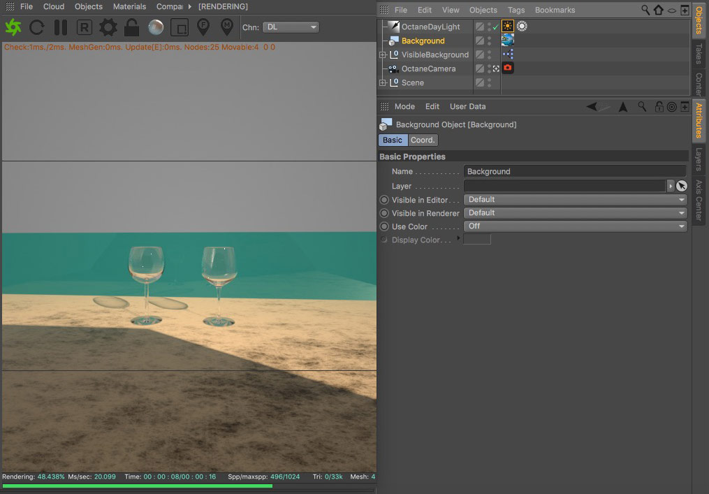

I'm a bit confused by this, I seem to have lost my reflections.
I did two set ups, one with just a hdri and the other with hdri and back plate using script but have lost my reflections... see attached
Apologies if this is a bit noob :?

Hi Burgess AK,
difficult to say from your screenshots, do you mind to share with me an example scene, even via PM?
ciao beppe

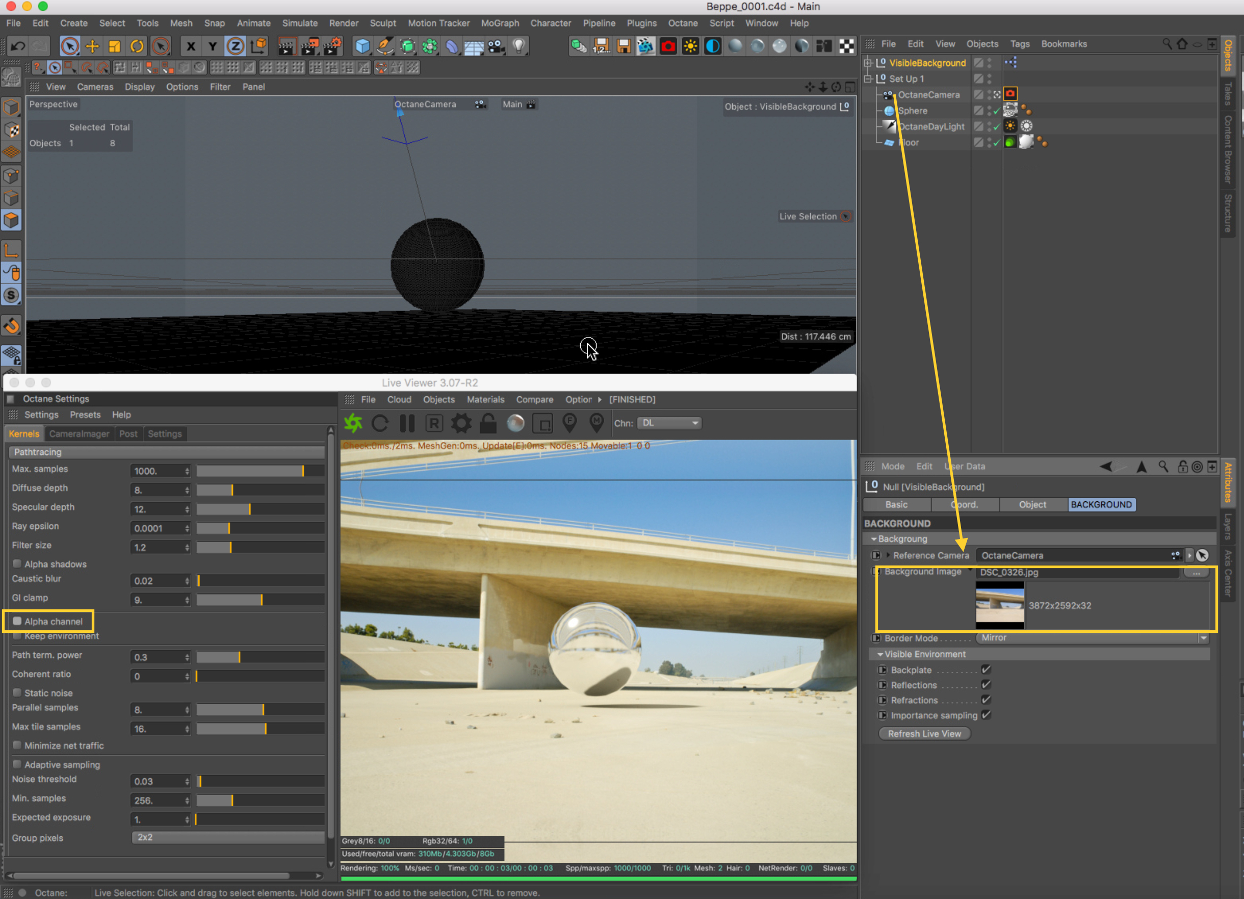

Posts: 10610
Hi Burgess AK,
thanks for the scene.
You need to have your Camera, and assign it to the proper slot in the Xpresso attribute tab:
Then you need to assign the proper backplate image, but do not need to change the nodes inside the VisibleBackground group.
