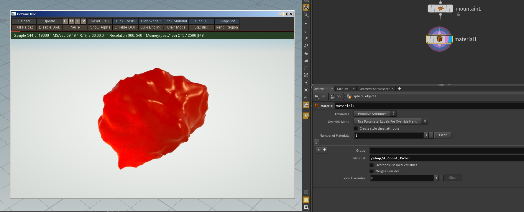

added the material but I do not see any change to my sphere and this is a error message .
houdini version 16.0.633
octane version 3.07.0.1
any solution?
material error

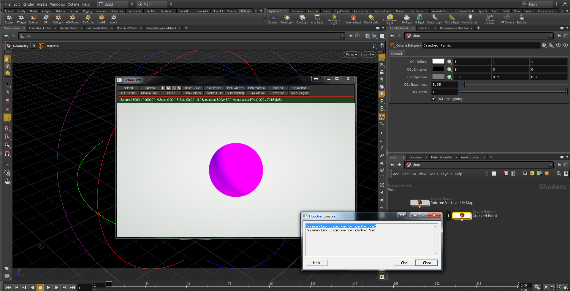

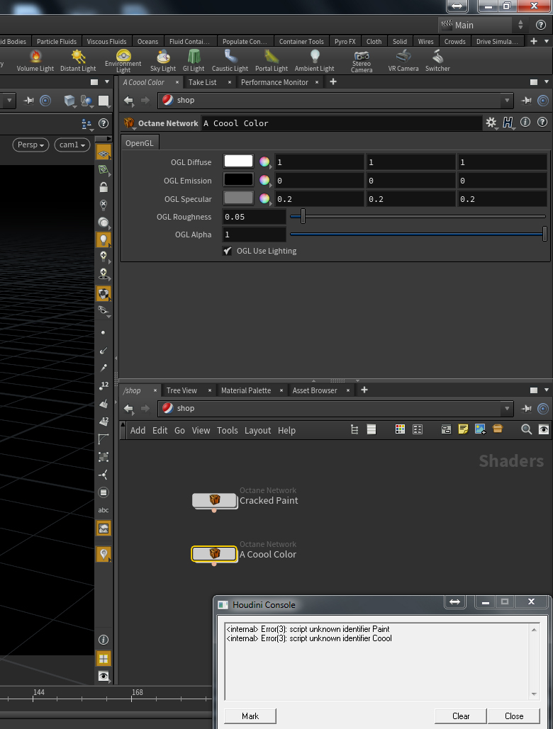

These materials come from LiveDB, right? I think that the main problem is they have space characters in their names, something not supported by Houdini. You need to rename the material node, removing the space characters. Also be aware that the "Cracked_Paint" material is not valid, it is only a texture node, without a material node to apply it.
