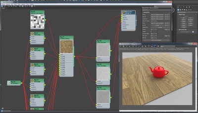

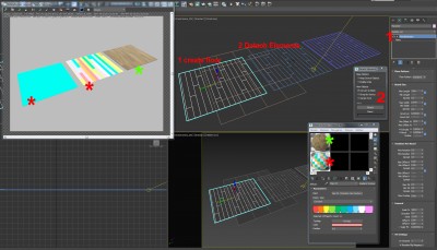

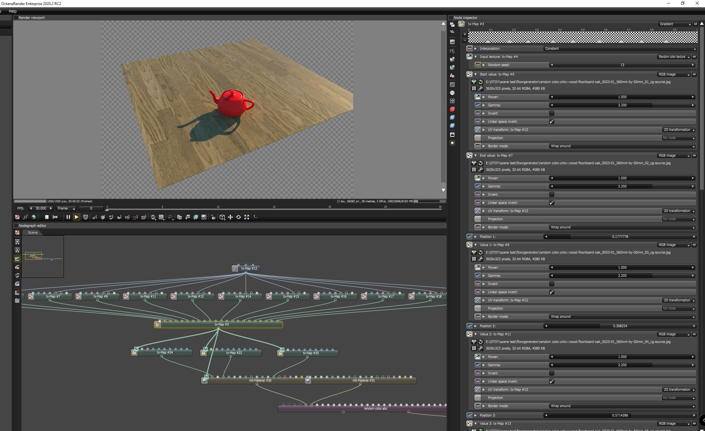

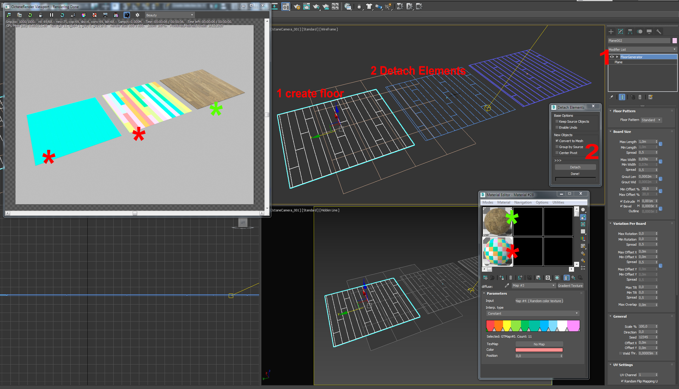

Hi guys,
waiting to optimize faster tools, a workflow to use floorgenerator.
I used an useful script, Detach Elements found on scriptspot.
Regards
Paride

paride4331, hi! Otoy are as usual invented a bicycle. Only in octane is it necessary to break geometry into separate parts. But if you do foliage? 3ds max will die on one tree, well maybe on two.

You dont need to detach elements.... floor generator.. if your using the one from cgsource has automatically created uv channels for each planks.. all you got to do is create a standard multi/sub-object materials and each slot add the glossy octane material maps. its a pain to detach everything when it already has assigned map channels...

There is a modifier called "material by element"... you don't need to detach

Does anyone know if this is still possible to achieve inside Octane standalone? :arrow:
