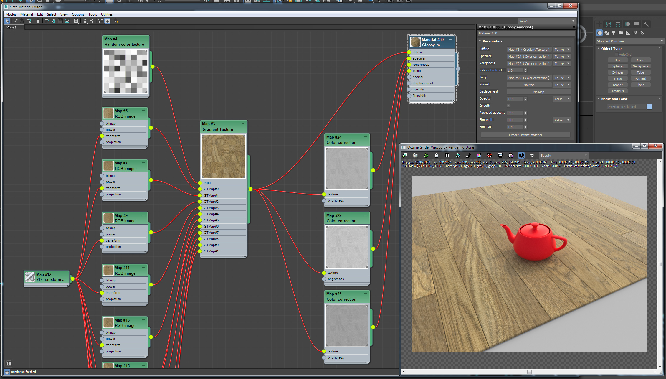

waiting to optimize faster tools, a workflow to use floorgenerator.
I used an useful script, Detach Elements found on scriptspot.

paride4331, hi! Otoy are as usual invented a bicycle. Only in octane is it necessary to break geometry into separate parts. But if you do foliage? 3ds max will die on one tree, well maybe on two.

You dont need to detach elements.... floor generator.. if your using the one from cgsource has automatically created uv channels for each planks.. all you got to do is create a standard multi/sub-object materials and each slot add the glossy octane material maps. its a pain to detach everything when it already has assigned map channels...

There is a modifier called "material by element"... you don't need to detach

I agree, These feature are in to-do list, releasing new SDK, devs should start developing.

Isn`t in MAX possible to generate a .csv and load that into Octane standalone through LUA? I thought Blender already had something similar.

At this time as far as I know floorgenerator doesn't support export data via .csv.
Basically the matter is that, until now, we don't have a multitexture node collecting files from a folder that works compatible with floor generators and similar programs. A good news is that we should have it in the near future. I have always been convinced that 3dsMAx Octane must bring attention to the world of architecture and design, implementing compatibility with important tools commonly used by professionals in the daily workflow such as floorgenerator or map nodes such as multitextures etc. and the tools ecosystem around 3dsmax. New material converter tool is a clear signal in this direction. New SDK should open a door in this direction. Every generalist 3d software has its own attitude that we all know; in this case, we know that 3dsmax is massively used by architects, product designers, interior designers etc. I am sure that by pushing Octane to take it into account, it can become a leader in the new generation archiviz render engine.
