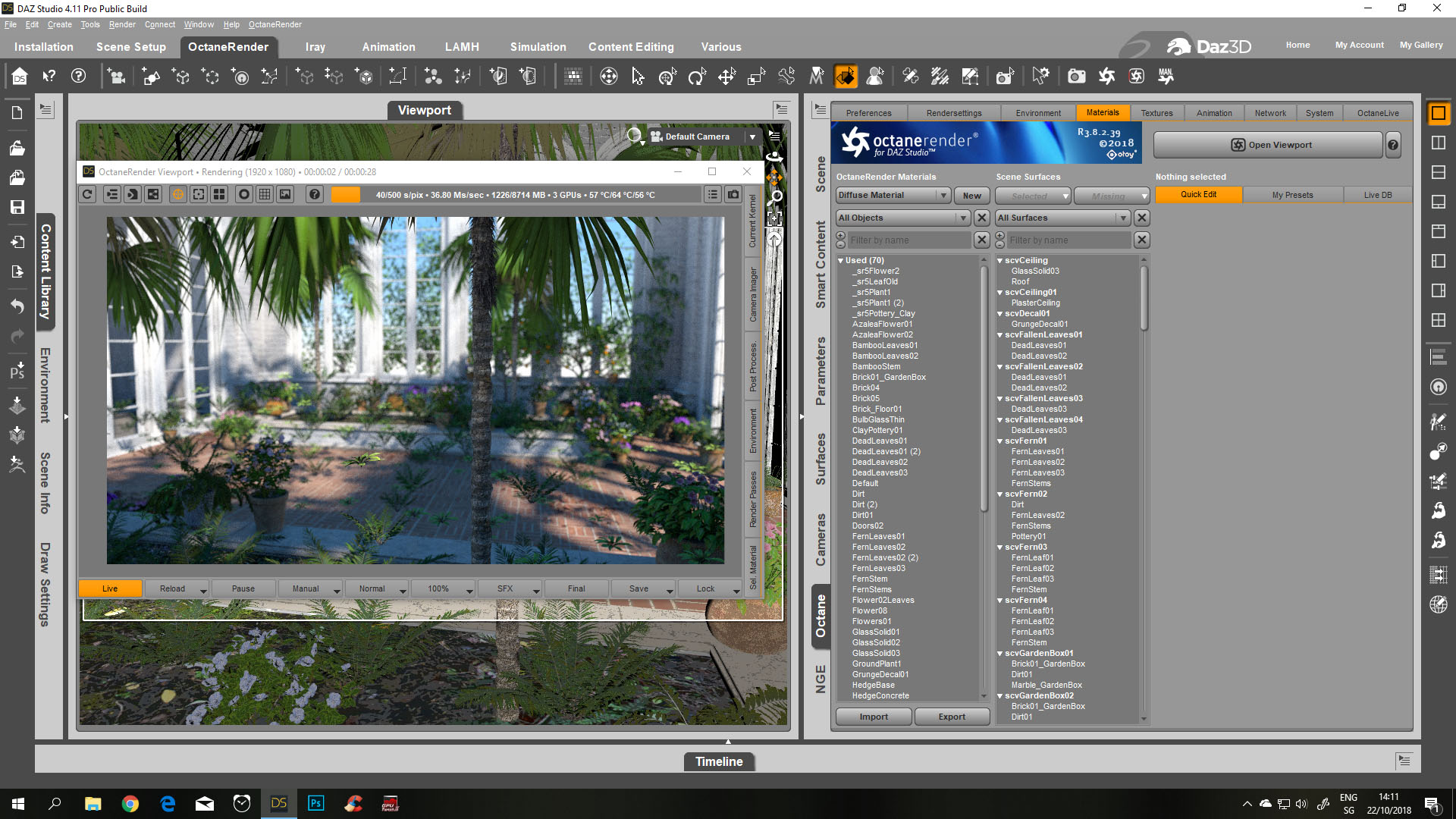

On my system Private Garden did not crash.
But clearly instancing is not working as expected.
There are plants all over the place in areas where should be none.
Step 1: Loaded the scene in MAN mode
loading the scene without materials
- allows you to test if the geometry loading triggers any errors
- makes sure that you do not exceed the available VRAM

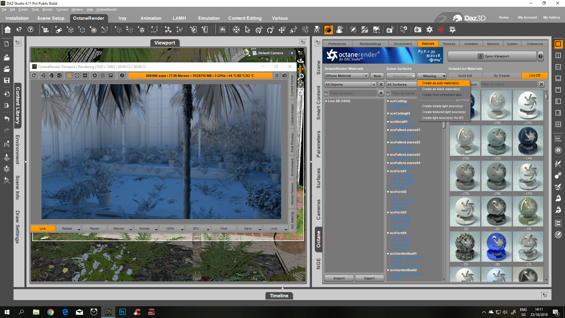

Step 2: Create auto materials
- this will allow you to test if material loading triggers any errors
- if the scene does not fit into VRAM try autoconverting one surface after the other
Scene loaded in Octane

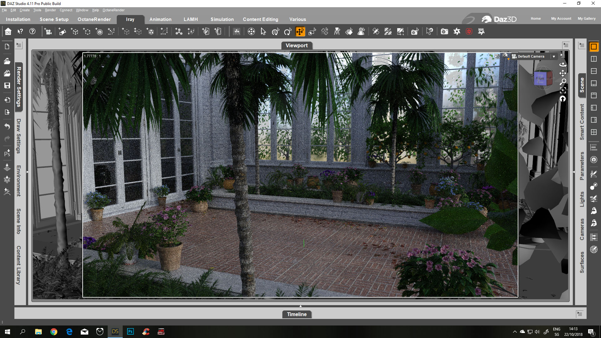

Original Scene in Iray
Speculation:
Maybe the faulty instancing is related to crashes other users are able to observe.
Maybe something else is the cause.
