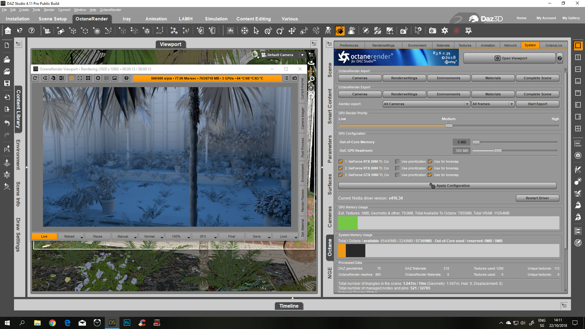

Tested this with
DAZ Studio Beta 4.11.0.236.
OctaneRender for DAZ Studio plugin R.3.8.2.39.
https://www.daz3d.com/the-private-garden
On my system Private Garden did not crash.
But clearly instancing is not working as expected.
There are plants all over the place in areas where should be none.
Step 1: Loaded the scene in MAN mode
loading the scene without materials
- allows you to test if the geometry loading triggers any errors
- makes sure that you do not exceed the available VRAM
Step 2: Create auto materials
- this will allow you to test if material loading triggers any errors
- if the scene does not fit into VRAM try autoconverting one surface after the other
Scene loaded in Octane
Original Scene in Iray
Speculation:
Maybe the faulty instancing is related to crashes other users are able to observe.
Maybe something else is the cause.

Private Garden had issues in certain older versions of Daz Studio (non-octane related), I think it only stopped crashing in later version of 4.10 and then 4.11 Beta,
so if you're still getting it you probably need to update the studio for it to work.
As for faulty instances I get them with Private Garden and Heart of the East product no matter what I do in Octane with them,
my only explanation would be that Octane experiences memory issues with those.
Scenes like Howie Farkes ironically work for me even though I could swear they use more memory than Stonemasons.

I have a 6GB nvidia card and 32GB main RAM running DAZ Studio 4.11 Beta and R4.0.0.40 of the plug-in... and still, that private garden splatters instances of weeds everywhere.
Stefan (stonemason) assures me it ain't his fault. So just don't use those packs and the problem goes away.

Yep same here with Private Garden and Octane and Heart of the East as well, I'm on GTX870, 4GB vRAM and 32GB RAM.RGUS wrote:valzheimer wrote:Private Garden had issues in certain older versions of Daz Studio (non-octane related), I think it only stopped crashing in later version of 4.10 and then 4.11 Beta,
As for faulty instances, I get them with Private Garden and Heart of the East product no matter what I do in Octane with them,
I'm sure Stefan did everything alright by the scattering script, otherwise it would've shown faulty in Iray to begin with.
Crashing the Studio issue I know has been about DS version though, it was something Iray-related that worked after shader update, but crashed older version if I remember correctly.
It's a shame because scenes like that are exactly why I use Octane because Iray hogs awfully on me with big scenes. Some other version will fix it hopefully.

Anyhow, since this was driving me insane I found what the culprit is in the private garden scene -
both flower boxes have proxy instances, meaning hundreds of little ferns under ultra scatter node.
They're the ones that are flying all over the scene, as much as scene may miss such detail in a render,
when you delete them scene will finally clear out.
Hope that helps.
V.
Hope that helps.
