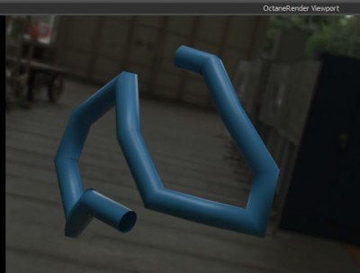

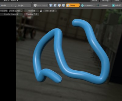

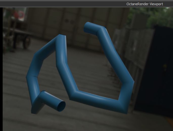

I've got some curves that render fine in modo's renderer but noticed octane doesn't match the same smoothness and looks like low poly and not as smooth.
Does anyone know any setting that can control the way the Octane plugin can render it accurately?

You can fix this by adding more points to the curve.

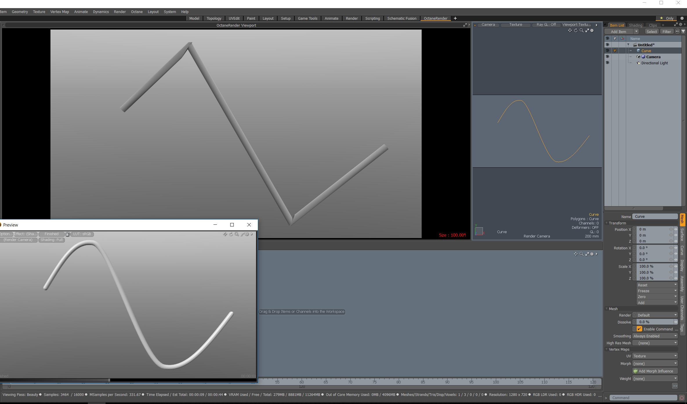

Paul, here is another sample with screen caps of both renderers. Is there no way to match and use the same points that modo uses to create smooth looking geometry?

A workaround is to add a "Curve Rebuild" Meshop and make a small Point Spacing. So you can edit your original curve and get a smooth render. But it would be nice if this would work out of the box

The OctaneRender for Modo plugin is picking up the vertices from the curve - so if there are only 4 vertices, the curve will look poor. More vertices = a better render.
