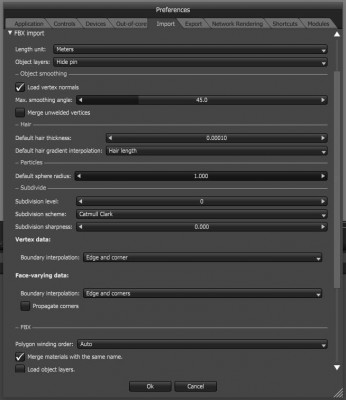

Hello, Just reporting back on FBX.
I see more consistency with timelines and geometry, hit or miss with characters.
For example, current iteration does not like Daz Studio FBX character exports, sometimes crashes, or loads in with slots for the geometries, but then in viewport, no respective geometries are present. Or, some will be missing. (ie - I will see eyeballs, jaw, and hair, but no body...) In these cases, even if you load a material in to an invisible geometry, it does not appear in viewport as the underlying geometry wasn't present in viewport to begin with.
Then, there are times when other character files load in fine, with a camera, and with a timeline. Just no materials. But the full geometry of the figure is there.
Just curious- is the intended end FBX import option going to support textures (like an OBJ) or will they need to be loaded in separately (like in alembic)?
I see in the import options for FBX there is a settings dialogue related to textures, but I haven't seen one file make it into Octane via FBX import with any loaded textures yet, so I wasn't sure.
And assuming all is well and a geometry is present, the material slots shows "No Node", ready and needing for a texture to be manually added in.

Notiusweb wrote:Hello, Just reporting back on FBX.
Thanks for the report. Could you send us a few of those scenes that are not imported correctly? Thanks.
Material import is not supported at the moment and is not planned for the near future. There are also no material import options for FBX.
The option for "merge materials with the same name" in FBX import made me think that it was a material import option for FBX.
But I see, it is not related to bringing the mateials in, but more related to the management of the scene elements somehow once brought into Octane, like if you apply a material manually to an empty node, it will only have to be applied to 1 channel/slot, as opposed to multiple, if there were otherwise multiple same name materials? Or something like that? I wasn't sure.
