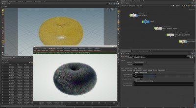

Hey so I followed the guide used for particles you have in the documentation to get fur to pickup the Cd color but doesn't seem to work right and I don't know what I'm doing wrong. I created a shader assigned the PPM texture to the diffuse. Then on the octane parameters I ticked on Cd colors.
It should work, but the hair curves need the Cd attribute at the primitive level. Attached you have a sample scene, you only need to set the texture from your folder in the hair material.
