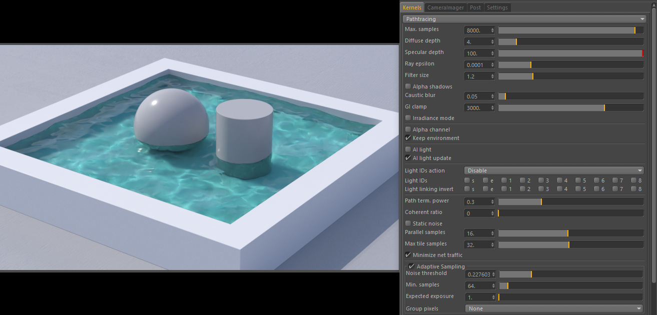

Here you go...
Be sure to turn off "Fake Shadows" on your water material. Use transmission to color the water. Increase samples and or GI clamp for more details. Use a sun light with small size.
