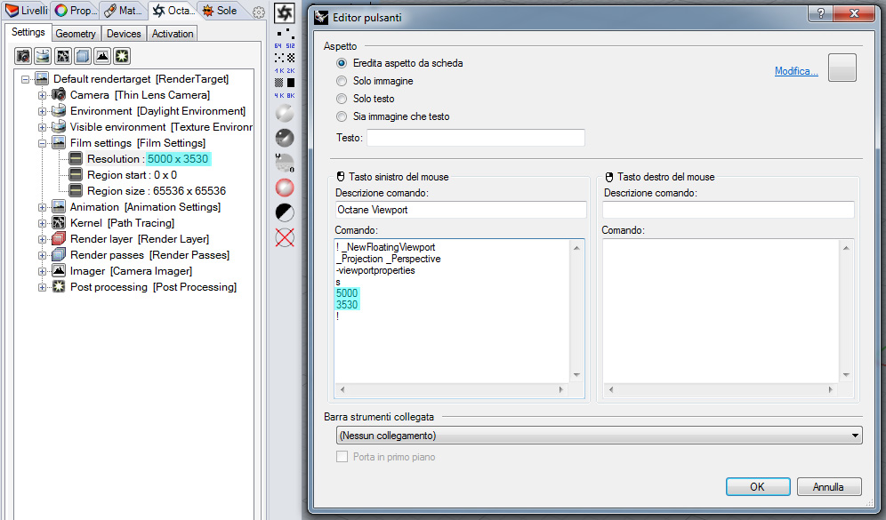

I'd like to create a button that creates a new viewport with the same size of Film Settings Resolution. Now I write the film size manually in the script of the button.
Do you know how to copy the values of the octane film setting and put automatically in the script?

I'm not sure you can change the resolution settings via a Rhino command. I will need to check early next week, and add that functionality if it is not already there.

here is a button that creates a viewport with the dimension (or percentage) of the Octane rendering viewport. The script isn't mine because I'm not a coder. I asked in the Rhino forum how to write this script and two coders helped me to build it.
For now, the resolution of this window doesn't come automatically from the octane film setting. You have to change it manually (shift+right click) inside the code of the button.
