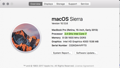

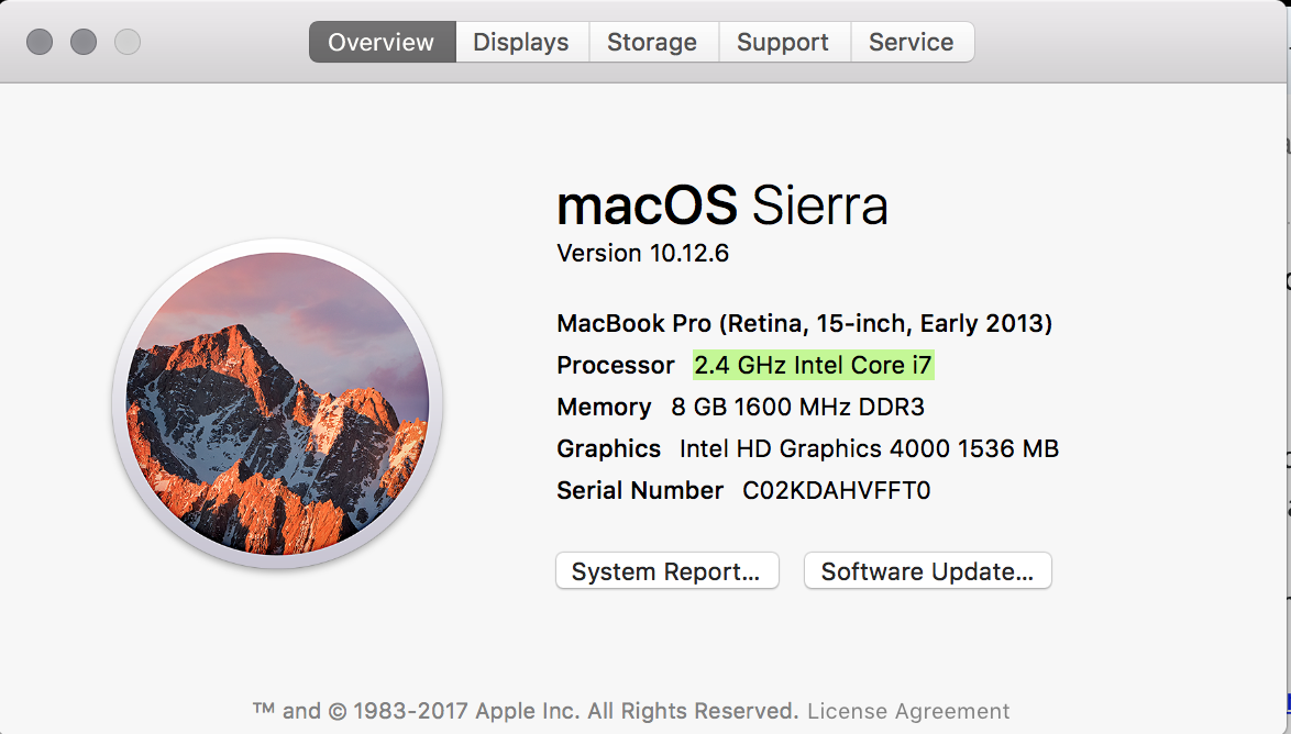

Not sure where best to speak to you but here is a screen shot.
Posts: 10616
Hi Nathan,
unfortunately the issue here is the Intel Iris Graphics, while it is still necessary a CUDA capable Nvidia GPU to execute OctaneRender.
Hopefully the eGPU solution is going to be more easy to adopt, since Nvidia has just released the first drivers for High Sierra with eGPU support:
https://www.nvidia.com/download/driverR ... 5379/en-us
ciao beppe
