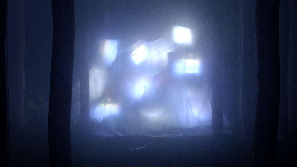

Hey guys, I've got a tricky scene. I'm rendering multiple TV screens, under a transparent cloth, sitting in a dark forest.
The emission textures (TV screens) are the only source of light because I went them to illuminate the environment. I have a little SSS fog to pick up the light coming from the TVs

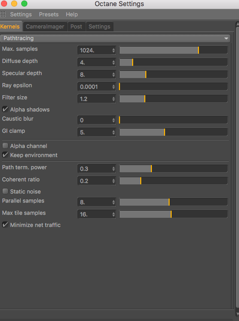

Any tips on optimizing this render? These are my current settings.
My main concern is noise. Right now I'm at 6min a frame and still got lots of noise dancing around.
This is for animation . Thanks!!
SSS fog + emission textures = lots of noise. tips?

Note that you have the Coherent ratio active, but the Static noise unticked, so a bit of flickering is expected.
Please, enable the Static noise option, set the Parallel sampling to 16, and Max tile to 32 for final rendering to speedup the calculation.
If you switch to 3.06.2 you can enable the Adaptive sampling, increase the Coherent ratio, and reach an higher sampling level in the same amount of time, with less noise.

Only my feeling, i would try to put a higher Caustic Blur than zero to speed up the render. Maybe something around 0.3.

For the TV screens, i suggest also to try a pure black color in Diffuse of the materials with emitter. This should help for the noise.You'll need to update your Cinema 4D to latest versions(16.050, 17.053 or 18.039). Otherwise the plugin will not work and not appear in menus.
