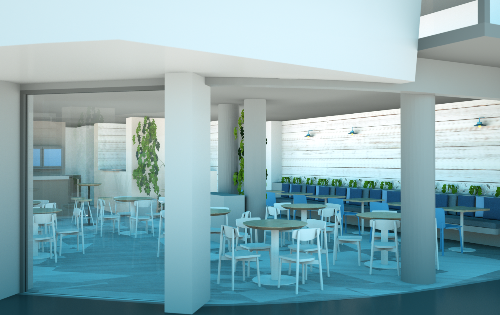

I am using the Daylight environment for DL AO render. Loving the speed but also having to cope with a blueish hue over over my floor which I am thinking is due to sky colour.
(When I use the texture environment , the bluish hue doesn't get represented on the floor)
It is a interior render so I dont know why the sky colour is coming on the floor material.
Am I missing something?
Many thanks in Advance

Hi - it is hard to tell without seeing some screenshots of the problem. But the daylight sky is blue, so it is possibly the problem.

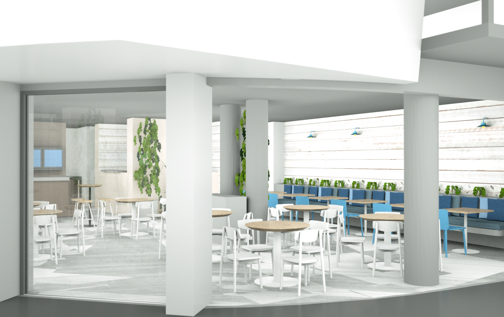

attached are 2 images
top image is daylight (notice the blueish hue on the floor)
2nd image is texture being white (254, 254, 254)
Interesting, I haven't seen that before. It would be good to see a screenshot of your Imager and Environment settings. Perhaps there is a large reflective surface which is reflecting the blue sky into the scene.

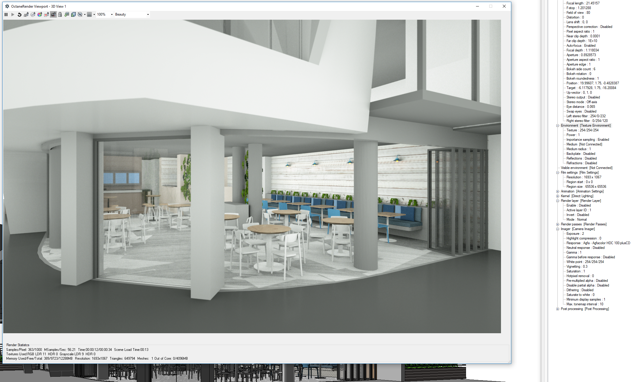

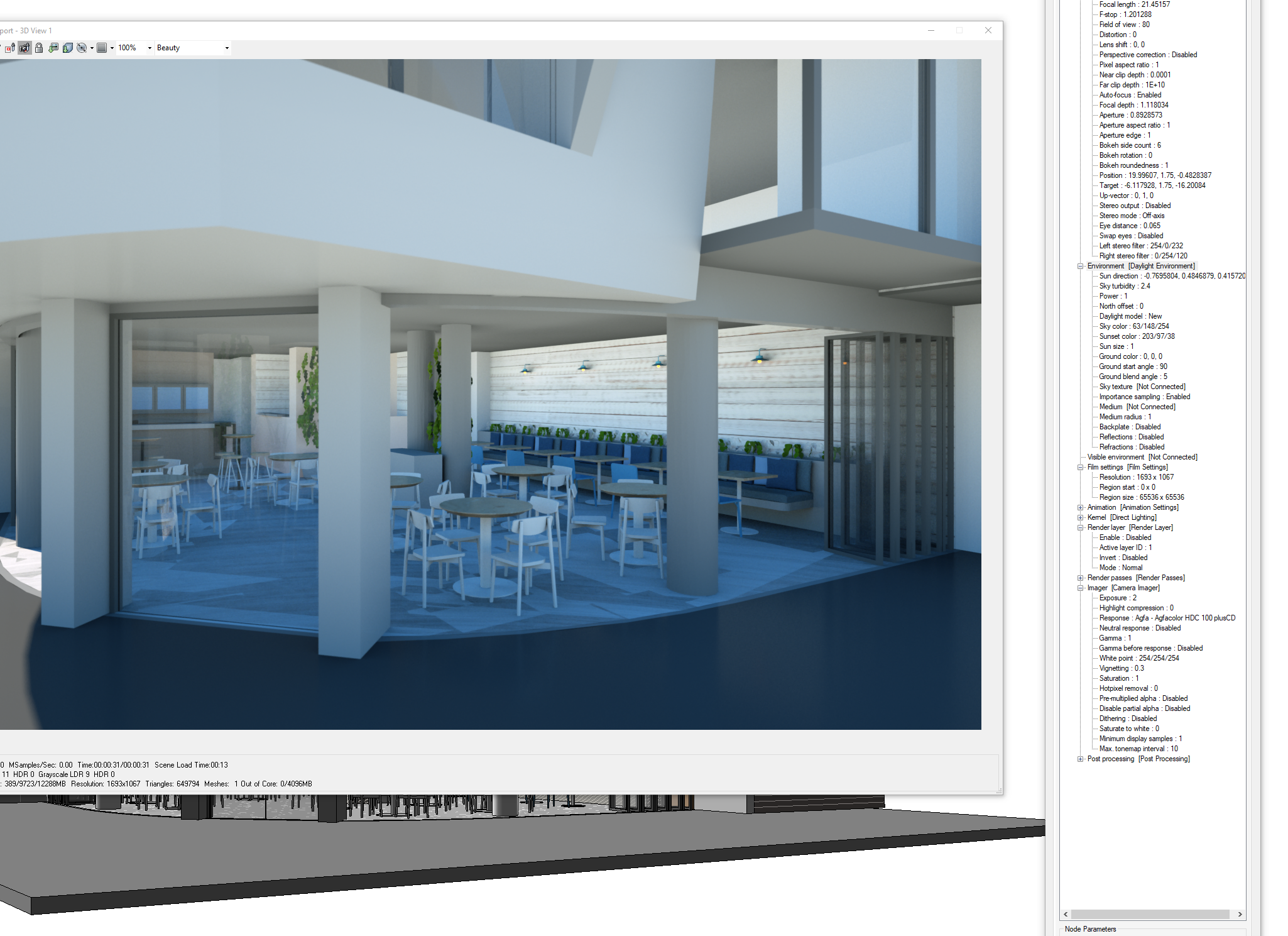

texture
texture
thanks Paul
image attached

I think the blue is coming from the reflection in the glass (which is reasonable). You can test this by setting the Reflection of the glass material to 0/black. Perhaps there is no ground - so the glass is picking up reflections from the sky from every angle?
