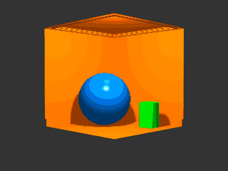

Is it possible to recreate this effect in Octane? I've tried using a mix material with the side node and a transparent outer material, but the walls just turn black. I'm primarily trying to create just the invisible walls, not the fading in based on normal part.

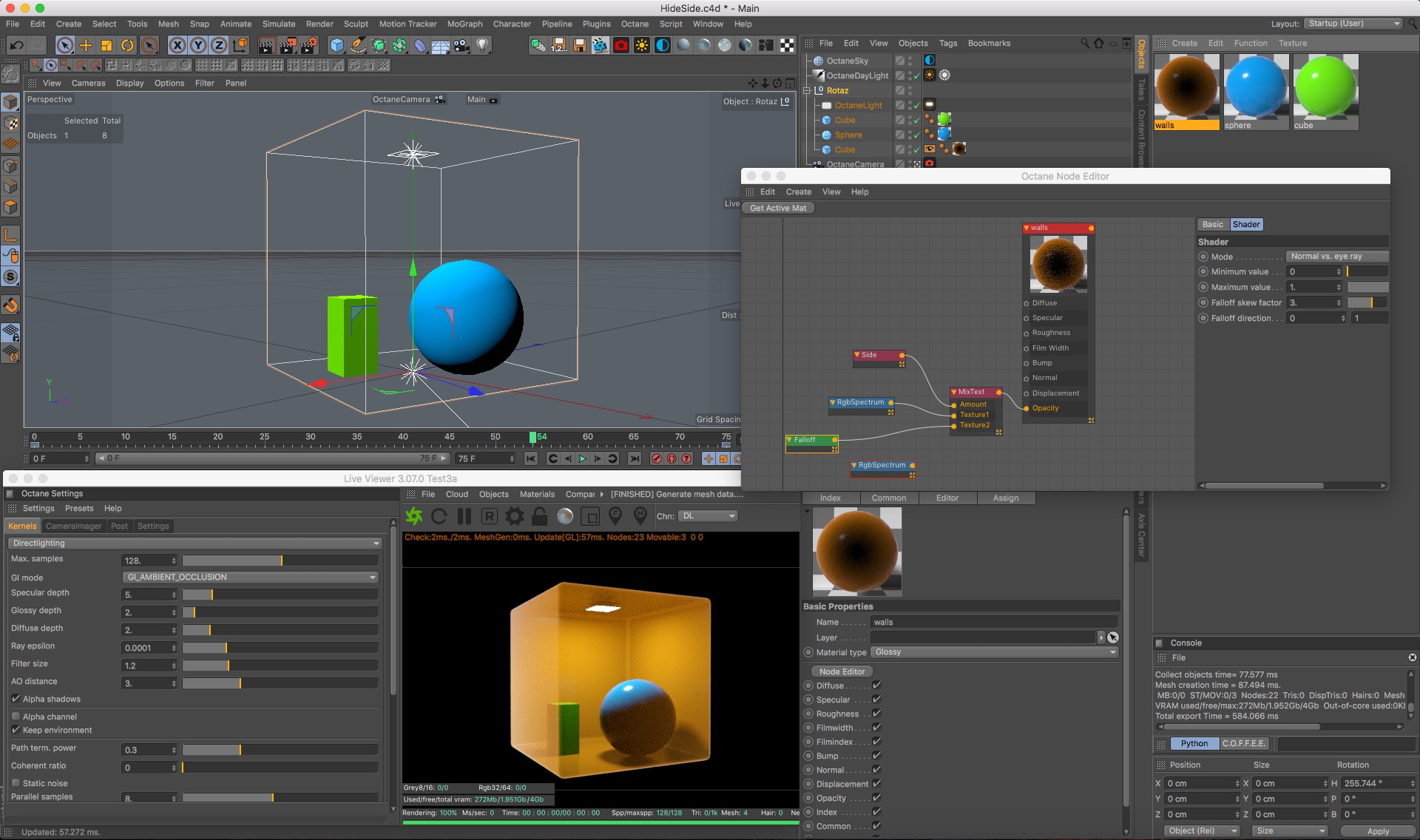

base80 example?
Anyway, here is the example scene file:
HideSide.zip
(181.13 KiB) Downloaded 271 times

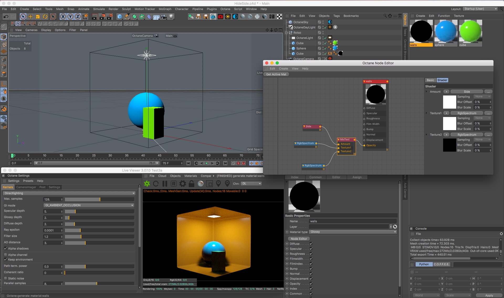

simple
simple

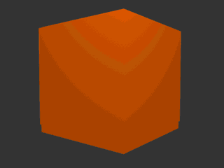

And here is with a Fallof node instead of the black node in the mix terxture:
falloff
falloff
