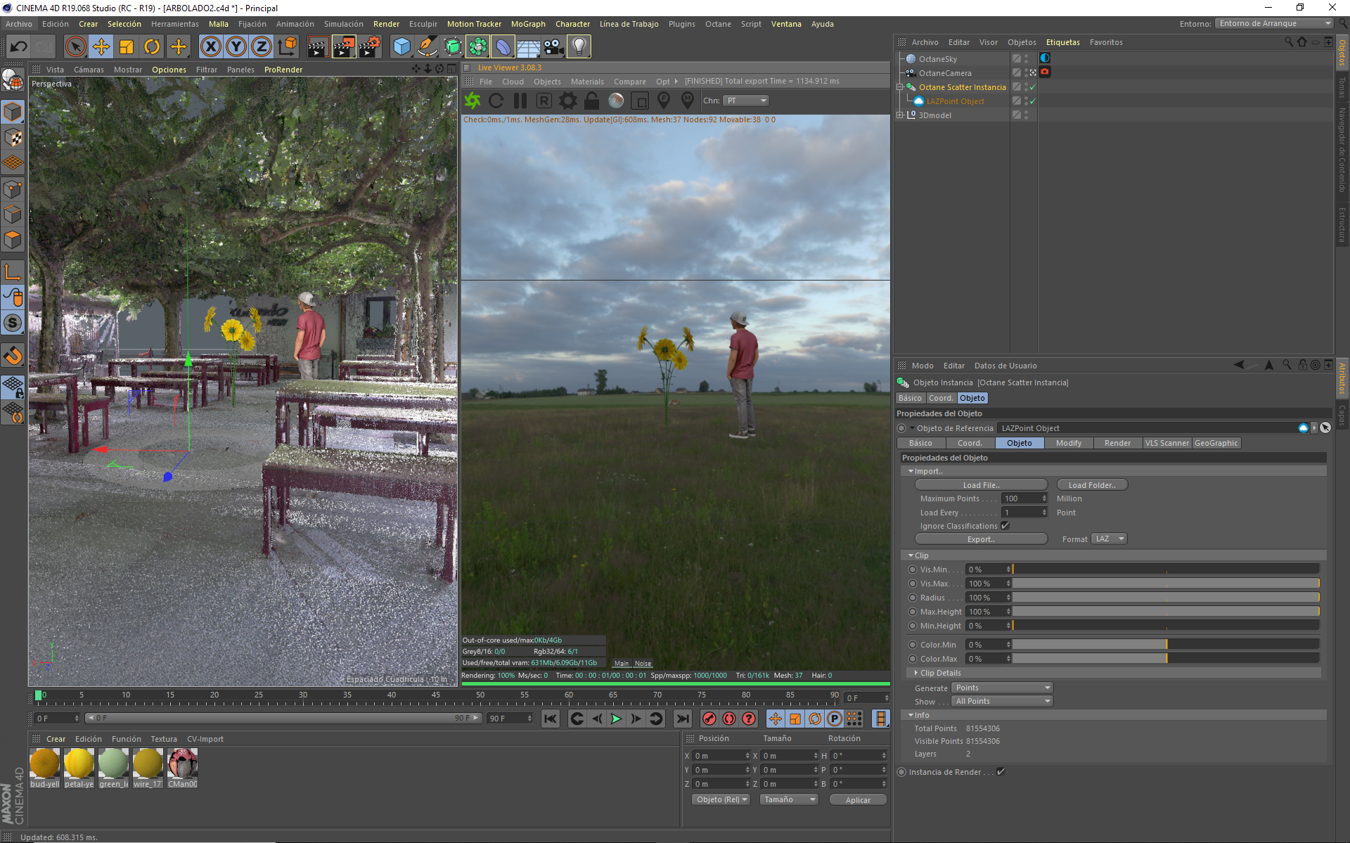

Hi Ahmet,
I've loaded a Pointcloud file using LAZPoint plugin.
I've used instance object as you said but i don't know how to make it works.
can you help me?
thanks

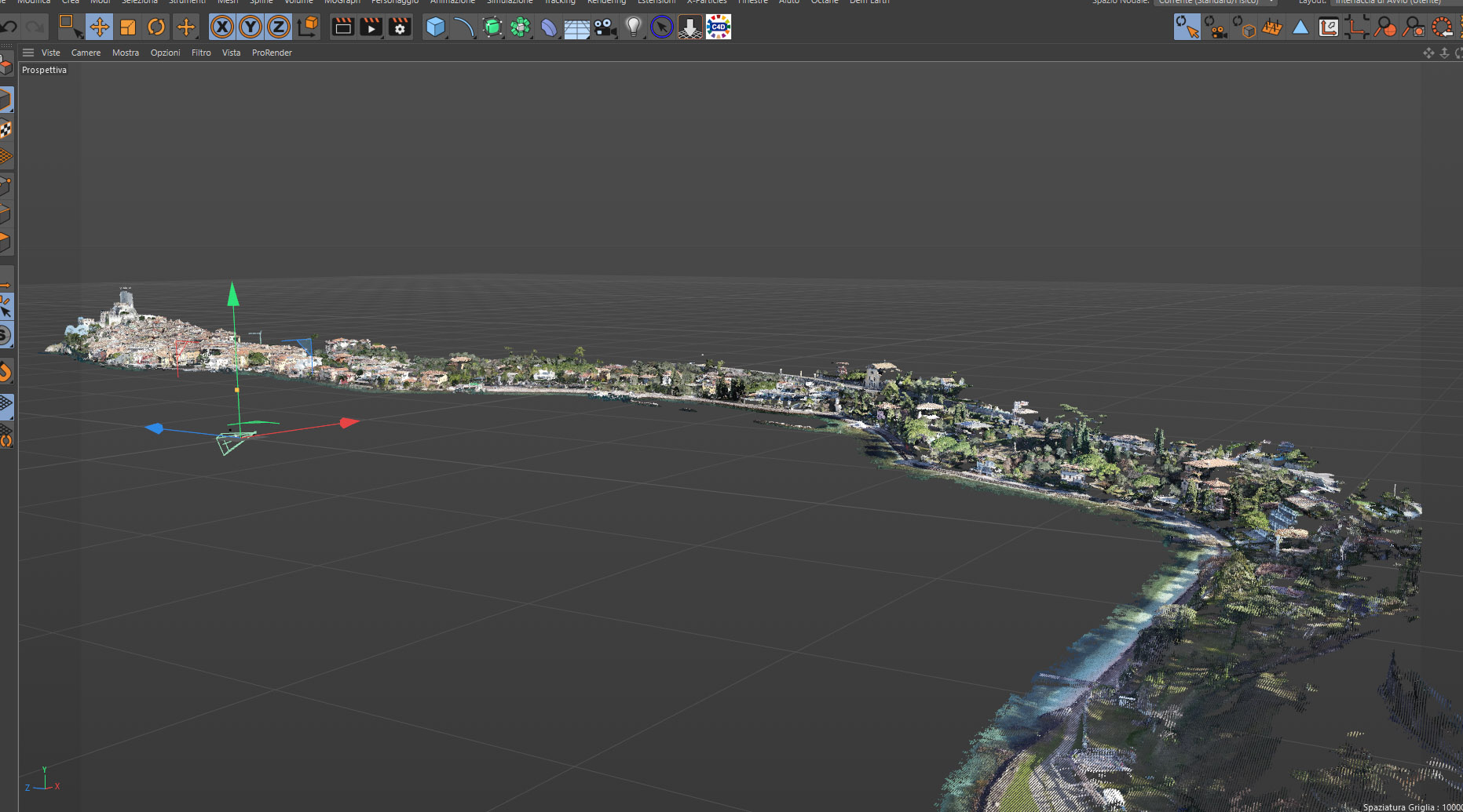

I have just bought this very useful plugin and load my Cloud point file.
Now I need to render in some way this object (also in white color) and I have the choice to generate XParticles / Multi-instances / Hair...
I hope this could be of interest of other users, so can someone give me a tips in order to do that?
Thanks a lot.
Luca

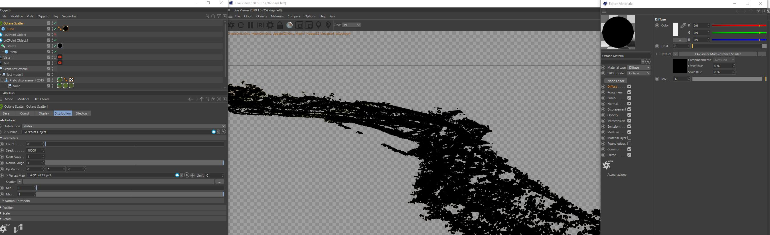

...mmm
I have made many attempts but the results are always black colors, it seems that Octane can't use lazpoint multi-instance shader.
I can send you,if you want, my Cloud point file if you think is useful (and if you have time to try ...)
In other way could you teach me if I've setted correctly the lazpoint multi-instance shader?

Backing to our problem I've tried all your suggestions but nothing to do, Octane seems to not recognize lazpoint multi-instance shader.
Other idea how to put color on our points? :D
